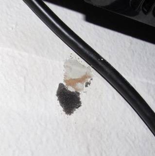

A lot of you seem like the "handy" type so maybe you can give me some advice. A friend of my had some acoustic foam on his wall (with spray-on adhere stuff), removed the foam, and now some foam is stuck and in other spots some of the paint was removed.
1. How should I remove the remaining foam without damaging the paint?
2. The spots that are missing paint due to foam removal, what's the best way to repair?
Thank you for your help :)
If it were me I would just pull or scrape or whatever is needed to remove the foam with the minimum damage and then repaint.
Same. Scrape everything off, grab a sample square of the paint from an affected area so you can get the paint mixed to the proper color, sand the affected areas, and re-paint.
Sometimes heat will soften adhesive. A woman's hair dryer might be just the ticket for removing the remainiing foam.
That looks like a textured wall.
The fellows at your local lumberyard can suggest suitable repair products.
There's textured paint in spray cans now, and something called "knockdown".
Three words men fear most are "I don't know". Go in your lumberyard and ask for their help. They'll not think less of you..

Heat could be a good idea, perhaps try dampening it as well. Steamers are a good way of getting most things off walls. For the blank spaces so long as there's no damage underneath (broken plaster for example) just touch them up with a small pot of paint.
This stuff has always worked wonders for me. If you do try it, do a test area first.

WD 40 has a good record for removing adhesives and gunk from just about anything.

Gently brush some turp's or similar solvent onto the foam and "melt" it off. Simple's!
Just use WD 40. Soak it in, it'll start to dissolve the foam and the goo.

WD40 will likely leave residue to which your touch-up paint won't adhere. Test it somewhere inconspicuous..Veli's turpentine might work and has a pleasant piney smell.
Beware of solvents like acetone that attack the styrofoam, you'll get a real mess.
I'd try rubbing alcohol to soften the adhesive, but first open all the doors & windows.
You don't want explosive vapors of any sort to build up.
They are generally heavier than air and will collect on floor or in basement. Ventilate!
