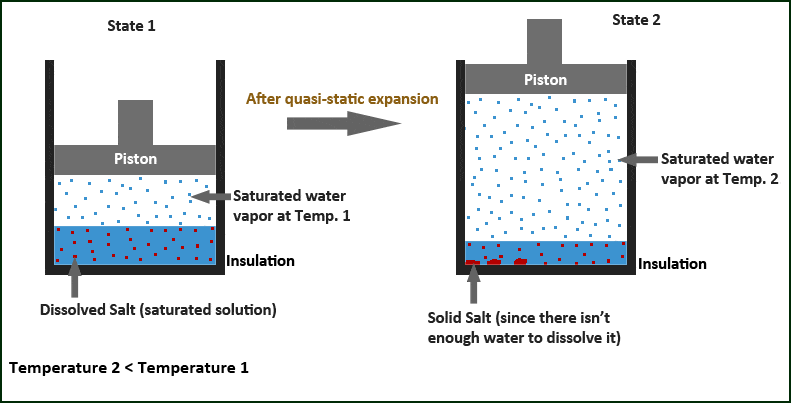

If I have a container containing a liquid mixed with some other substance that has much a higher boiling point (i.e. water and salt). This liquid will be in equilibrium with its vapor (the salt vapor pressure is negligible).
Now I quasi-statically adiabatically expand this vapor. Isentropic process right?
But after some time, I've essentially distilled some salt. I can cover up the salt rocks, then begin to compress the vapor, again slowly. This compression is Isentropic right?
What's going on, what happened to the entropy of this system?
Sorry if this is a bad question with a trivial answer, it is late and I'm tired. Thanks for the help.

I guess I didn't understand your system. Can you explain a little better about what you mean by "Now I quasi-statically adiabatically expand this vapor."?
I apologize for not being clear. I drew a picture.

  • Two-state piston diagram: left, a cylinder with a piston over saturated water vapor at Temp. 1 above a blue saturated salt solution with dissolved red salt particles; right, after quasi-static expansion, the vapor at Temp. 2 above a blue layer with solid red salt at the bottom. Text: Temperature 2 < Temperature 1.
This is a good question. I think the resolution becomes clearer if we look at a related problem. Suppose we have a mixture of 2 ideal gases, A and B in a piston. The piston is pressed down to start with, and right below the plunger of the piston there is a stationary semi-permeable membrane that let's gas B through but not gas A.
Suppose we now expand the piston adiabatically and reversibly. In fact, let's take the limit where we expand the piston infinitely far. Now comes the reason I chose ideal gases, because we can calculate the entropy exactly. The entropy change for a pure gas changing from a state (V1,T1) to a state (V2,T2) is

Now, just like in your example, let's block off the semi-permeable membrane and put some solid material there to block both gases before we compress. This way we will separate the gases isentropically. Let's assume V2>>V1, so that the amount of gas B in the same part of the container with A is negligible. There are two options for how we compress adiabatically. We could make the blocking material insulating or conducting. Let's make it insulating so we can use the normal formula for an adiabatic reversible compression, and say the gas finally reaches temperature T3. Let's compress it until the volume of B alone is back to V1 (but of course the whole container now has volume 2*V1 because the gases are separated):

So what if you now allow the solid separator to be a piston that equalizes pressure between the two chambers and compress the entire thing adiabatically so that the total volume is now V1? You can do the calculation and you will find that the temperature has actually increased! The work in compressing the gas back to its original volume will actually be higher when the gases are separated. The temperature increase increases entropy and now the temperature increase balances out the entropy of mixing term.
Keep in mind about the salt example: there will now be an enthalpy of mixing term that will make things more complicated. But the end result will be similar: The combined effect of changed overall system volume and the temperatures of the components will balance out the lost entropy of mixing.

The reason I was asking about the salt problem is that the salt isn't really an ideal gas while dissolved (are ions free to move, or are they bonded?) and when it precipitates it is a solid with a small volume. I know that volume of water + volume of solid salt is not equal to volume of water with salt dissolved in it.
Could it be that the enthalpy of evaporation is different when salt concentration is higher? That could have something to do with it.
It will be very similar in both cases. Remember that the vapor pressure of water depends on the salt concentration. In an ideal solution, Raoult's Law will be followed so that the vapor pressure will be proportional to the fraction of water. Ionic salts obviously deviate from from Raoult's Law, but the qualitative behavior is similar.
Just like in the ideal gas case where if in the last step you want to bring everything back to volume V1, you end up doing more work in the compression stage than is lost in the expansion phase, the compression phase with no salt will require more work because there will be no salt to lower the vapor pressure, so this will result in a higher temperature and more entropy to compensate for the entropy of mixing.

Nailed. This is the answer, for future reference.
The confusion comes from looking just at the piston, since from its perspective it's only doing reversible work. But on the way down, it's a "different gas" (meaning it behaves differently) so you're comparing apples to oranges.
