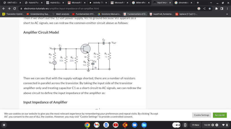

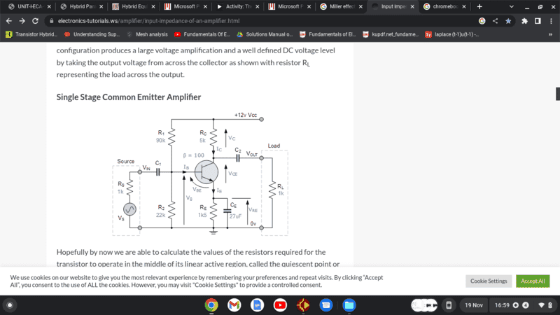

Hello,
attached are two screenshots showing a common emitter and the same with source voltage removes to find the input impedance.
How is it that resistors R1 and RC can be placed in parallel to work out the input and output impedances?
Examples i have seen only show straightforward instances of parallel resistances.
If possible can someone also knock up a spice simulation where I can see for myself the proof. t
Sorry, I don't understand. R1 and Rc are not in parallel. Can you show us you equivalent circuit for the impedance calculations?

I mean that R1 is in parallel to R2 and RC is in parallel to RE whereas before R1 was in series with R2 and RC was in series with RE.
Because the power supply is defined to have zero impedance and a constant voltage. For any signal except DC, it can be replace with a short circuit.
Even in DC analysis, the input and output impedances are defined by the change in voltage and current, i.e. ## Z_{in} = \frac{dV_{in}}{dI_{in}}##. So since the power supply voltage is held constant, you get the same answer for any value. That allows you to set it to zero.
Nope. There's a transistor in there, which has 3 terminals. Components aren't in series if there is any path that allows an electron to go around one of them.

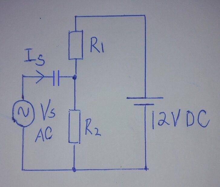

ntetlow said:
How is it that resistors R1 and R2 can be placed in parallel to work out the input and output impedances?
This is a conceptual problem. Please see the picture below. How to calculate the AC current ##~I_s~##, isn't it obvious that ##R1## and ##R2## should be connected in parallel ?
According to the principle of superposition, the current of the circuit can be calculated by using the AC voltage source and the DC voltage source respectively, and then adding the two currents to obtain the total current, but you only need to care about the AC current for calculating the AC impedance in this example.
