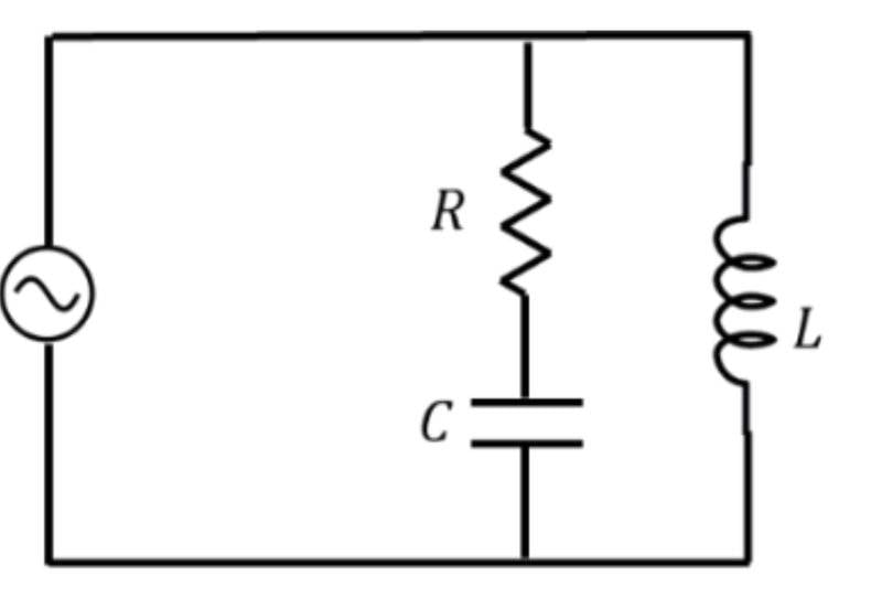

^^ as mentioned in the homework statement, the relevant equation is my worked out impedance for the circuit. I have attached a diagram of the circuit below.
  • Circuit schematic of an AC voltage source feeding two parallel branches: one branch has a resistor R in series with a capacitor C, the other has an inductor L.

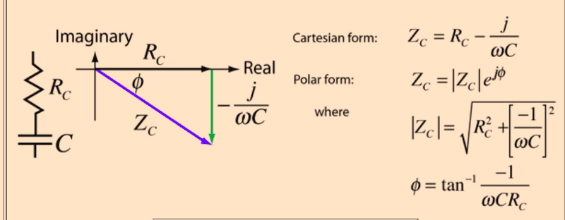

Is it like this? for the branch with resistor and capacitor,
Diagram of a series resistor-capacitor branch with a phasor plot of its impedance: R_C on the real axis, -j/(omega C) downward on the imaginary axis, resultant Z_C at angle phi, with Cartesian, polar, magnitude and phase formulas.
And then for the branch with just the inductor in it its just wLe^90j?
And then I need to add them together which is 1/Z = 1/Z_l + 1/Z_c?

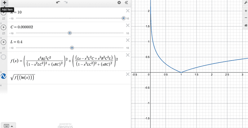

Okay,
real part of |z|^2 is $$ \frac{w^4RL^2C^2}{(1-w^2LC^2)^{2}+(wRC)^{2}} $$ and imaginary part is $$ \frac{wL-w^3L^2C+w^3R^2C^2L}{(1-w^2LC^2)^{2}+(wRC)^{2}}$$
And then do I need to take the square root?

Oh wait what I got above is z1^2 and z2^2 so then I just need to take the square root of their sum?
No.
If you have $$Z=\frac{iwL-iw^3L^2C+w^4RL^2C^2+iw^2R^2C^2L}{(1-w^2LC)^2+(wRC)^2},$$the real part is $$Z_1=\frac{w^4RL^2C^2}{(1-w^2LC)^2+(wRC)^2}$$and the imaginary part is $$Z_2=\frac{wL-w^3L^2C+w^2R^2C^2L}{(1-w^2LC)^2+(wRC)^2}.$$You need to find $$|Z|=\sqrt{Z_1^2+Z_2^2}.$$

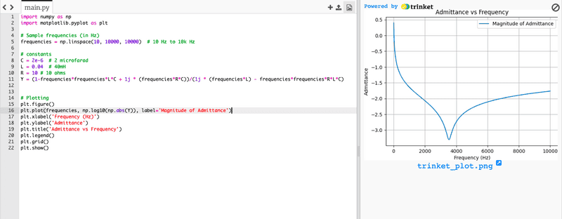

I'm trying to do this on python, neglect the fact that I'm plotting admittance instead, but why is the graph showing negative values? I don't think that's correct?
Screenshot of a Python script beside a plot titled Admittance vs Frequency, showing log10 magnitude of admittance against frequency from 0 to 10000 Hz, dipping to about -3.3 near 3500 Hz.

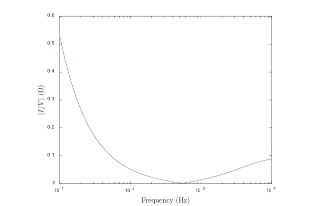

lys04 said:
By the way the solutions look like this
It's much more clear on log-log plot, which is standard. That way you will get straight line asymptotes for an approximate solution. Pro EEs will call the vertical axis dBΩ, which is ##20*log(|Z|)##, the phase is plotted as degrees, both with either a ##log(\omega)## or ##log(f)## horizontal axis.
