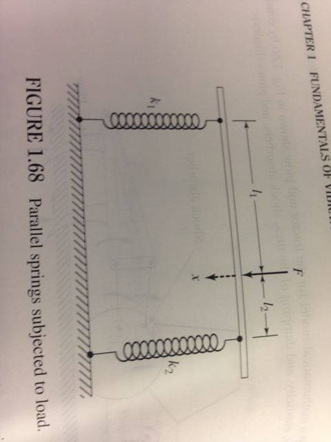

A system of two springs is considered, with spring constants k1 and k2, arranged in parallel and attached to a massless rigid bar. The bar remains horizontal when no force on it is zero. Determine the equivalent spring constant (ke) that relates the force applied a distance l1 from one spring and l2 from the other (F is between the springs) to the resulting displacement for small oscillations

A picture would help.

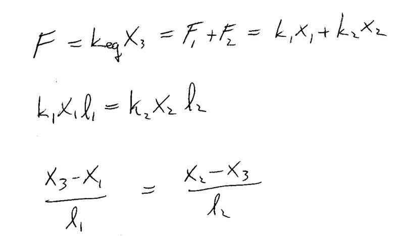

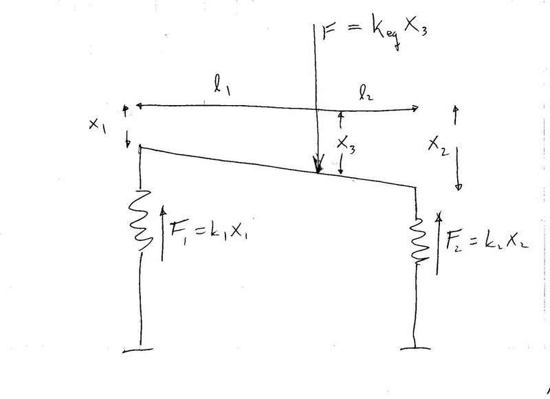

The force F causes the two springs to compress until equilibrium is reached. At that point the sum of the forces in the vertical direction sum to zero. Also the sum of the torques about the point the force F is applied is zero.
That may be true but it is not enough.
You get three relationships, sum forces in vertical = 0, sum of torques about the point of applied force F = 0, and a geometrical relationship between x1, x2, and x,3. See below. Solve for ke.
