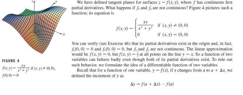

So the example says fx(0,0)=0 and fy(0,0)=0 (the partial derivatives).
When I try it I'm getting functions that are not defined at (0,0):
f(x,y)=xy/(x^{}+y^{})
so for example,
fx=[x(x^2+y^2)-2y(xy)]/(x^2+y^2)^2
fx=(x^3+xy^2-2xy^2)/(x^2+y^2)^2
fx=x^3-xy^2/(x^2+y^2)^2
Which I keep getting fx(0,0) being undefined. What am I doing wrong?
Your getting this because the expression for f that you use, is undefined in 0. That is, when you calculate the partial derivatives, then it's ok to derive the form f(x,y)=\frac{xy}{x^2+y^2} for every point except (0,0). But this will not help us in (0,0).
To find the partial derivatives in (0,0), you'll going to have to use the definition, I'm afraid. What is the definition of the partial derivative?? Can you calculate the limit involved?
