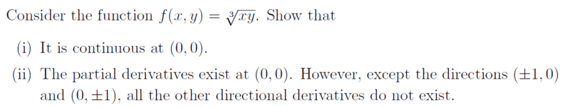

Typeset problem statement: Consider the function f(x, y) = cube root of xy. Show that (i) it is continuous at (0, 0); (ii) the partial derivatives exist at (0, 0), but except in the directions (±1, 0) and (0, ±1), all other directional derivatives do not exist.
