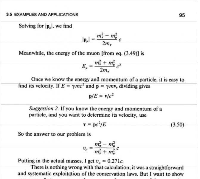

I've uploaded the example question from my textbook which shows what I'm trying to do
  • Textbook page showing Example 3.3: a pion decays at rest into a muon and neutrino, with the solution deriving E = mc^2 relations and the equation m_pi c^2 = c sqrt(m_mu^2 c^2 + p^2) + |p|c, then (m_pi c - |p|)^2 = m_mu^2 c^2 + p^2.
  • Textbook page 95, section 3.5 Examples and Applications, showing derivations of muon momentum |p_μ| = (m_π² − m_μ²)c/(2m_π), muon energy E_μ = (m_π² + m_μ²)c²/(2m_π), and velocity v = pc²/E (eq. 3.50), giving v_μ = (m_π² − m_μ²)c/(m_π² + m_μ²) = 0.271c.

The pion energy in the textbook example corresponds to your 2 Ee.

Since you already have ##p_\pi##, how is that related to the energy of the photon? I think that's what mfb is hinting at using the post 5 equation for. Now just thinking about energy conservation should give you ##E_\pi## pretty fast.
