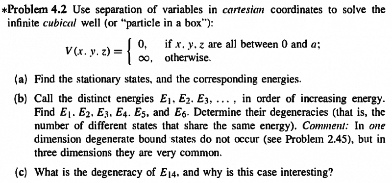

a) The schrödinger equation
$$i \hbar \frac {\partial \Psi}{\partial t} = - \frac {\hbar^{2}}{2m} \nabla^{2} \psi + V \psi $$
For the case ##0 \le x,y,z \le a##, ##V = 0##
$$i \hbar \frac {\partial \Psi}{\partial t} = - \frac {\hbar^{2}}{2m} \Big [ \frac {\partial^{2} \psi}{\partial x^{2}} + \frac {\partial^{2} \psi}{\partial y^{2}}+ \frac {\partial^{2} \psi}{\partial z^{2}} \Big ]$$
But with the sum of the second derivates, is it possible to set each of these equal to the time derivative separately? If so, then why?

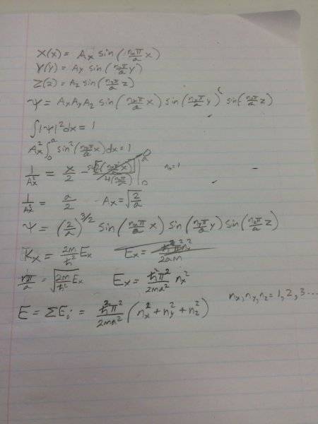

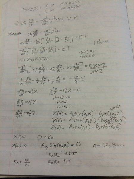

Okay I have made some progress on this problem, however I am curious, is it the case that ##n_{x} = n_{y} = n_{z}##? If they are allowed to be different numbers, I suspect that is what allows for degenerate energies.
Re your first question. If you have separate functions of each variable, then consider holding every spatial variable constant. This shows that the time function must be constant. In general:
##T(t) = F(x, y, z) \ \Rightarrow \ T(t) = C = F(x, y, z)##
And:
##X(x) + Y(y) + Z(z) = C \ \Rightarrow \ X(x) = C_x, \ Y(y) = C_y, \ Z(z) = C_z## where ##C_x + C_y + C_z = C##
But, there's no reason that ##C_x = C_y = C_z = C/3##
Is there any easy way to find a given ##E_{n}##? Or do you need to do every combination to get ##E_{14}##?
Not too many possibilities to get 14 as the sum of three squares ...
That is not what is meant by ##E_{14}##, they mean the 14th highest energy level. Not that the sum of the squares is 14
From the problem statement wording I'm inclined to say you are right.
Usually, we call them EN with EN = N E0 -- so I got sidetracked.
But then why Griffiths thinks E14 is so interesting is a mystery to me. Let us know if you find something !
