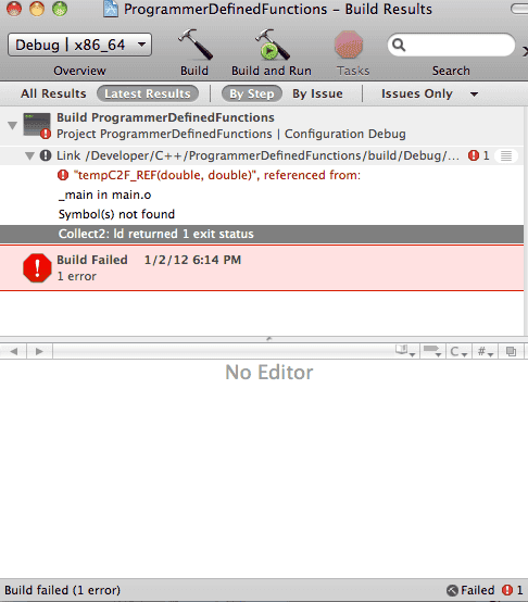

Hello all :smile:
I am trying to sort out how to use pass by reference properly and I am getting a Build error related to my pass by reference function. Perhaps someone could help me out here. I thought I was doing this correctly by reading my text, but apparently not. Maybe someone can point out if I am missing the obvious here:

Here is the build error I am getting:

You declared the function as void tempC2F_REF(double tempInCelsius, double returnByREF). When the compiler gets to the call in main(), all the compiler knows about is this declared (but not defined) function tempC2F_REF(double,double). Later you define the function void tempC2F_REF(double tempC, double& TRef). This function has a different signature than the declared function, so it is a different function. You never defined the function with signature tempC2F_REF(double,double), so you got a linkage error.
Fix your declaration to match the definition and all will be well.

I see now! I need to have void tempC2F_REF(double, double& ) in my function prototype. I unfortunately followed along with an example from my text in which they left the prototype as type functionName(type, type) and the actual function definition was type functionName(type& var1, type& var2). I should have investigated that before posting since it struck me as odd at first. I got lost in it all somewhere along the way...
