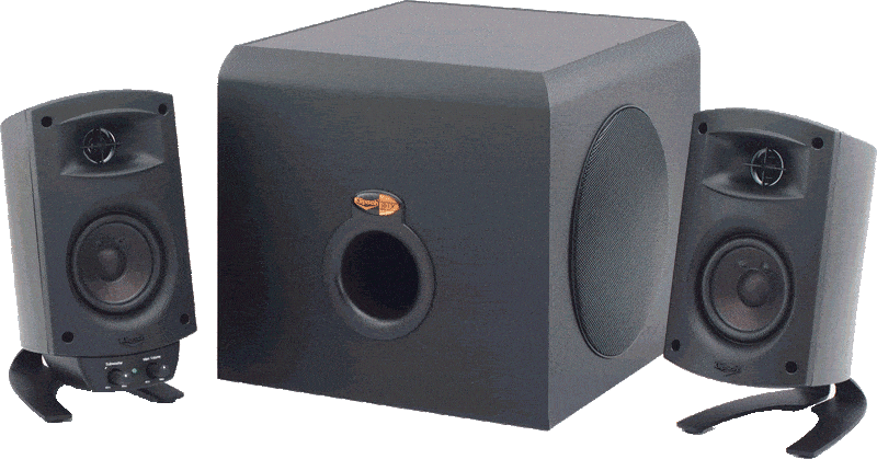

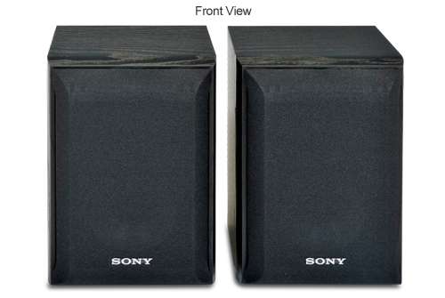

Hello, I'm not sure if this is the place to post this, but I'm hoping that someone here will be able to help me.
I am trying to hookup two Sony SS-B1000 speakers to a Klipsch 5.1 system subwoofer (I have attached images of each for reference). I only want to setup a 2.1 system for my PC desktop. When I first set them last night they were working fine, but when I went to watch a video today the audio is hollow and only originates from the subwoofer. There is no sound coming from the two front speakers at all. I updated the Realtek Audio driver and checked any possible settings that may have changed, but nothing is working. I pulled the subwoofer away from any power sources in case that might be causing some interference. Still nothing seems to be working properly. Does anybody here have any idea what might be causing this issue?

The subwoofer is designed for computer system and the book shelf speakers are rated 8 ohm impedance. I had the speakers working and kept the volume low enough that it shouldn't have overloaded them. I have had a similar issue before with a different set of speakers which leads me to believe its a wiring or connection issue, something within my settings. Also, I hooked up the Klipsch speakers that came with the sub and I'm getting the same result.
The speakers were doing this when I first set them up, but then I got the audio to work after messing around with it...got lucky. But the next day they sounded hollow again.
I plugged in headphones to the audio output jack and the sound quality was okay.

The Sony does have a tweeter on it. Here is the spec sheet from the Sony website : http://store.sony.com/performance-book-shelf-speakers-zid27-SSB1000/cat-27-catid-All-Speakers-and-Stereo-Components?_t=pfm%3Dcategory

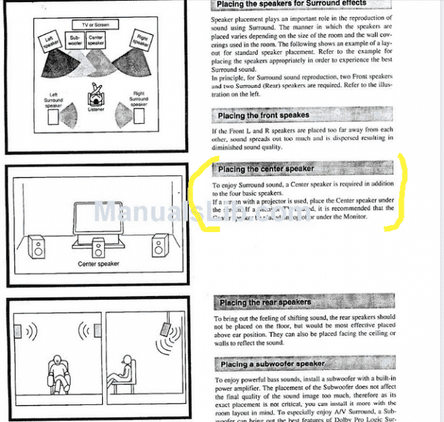

No physical switch for the rear ports. However, looking at the manual it does say that in order to use Surround sound a center speaker must be attached..? I have attached copy of the file. Is surround mode the only way to use the extra set of speakers on the rear ports? I chose to use the remote speakers because I was hoping for better output than I would get from using the rear speaker port.
That isn't the way I read that ( tho maybe its possible) I read it as you won't get the full benefit of hearing surround sound if the centre speaker isn't attached and positioned properly. you could always try any ol' speaker from the centre output position and see if it affects whether audio comes out the rear or remote speakers
Can you please do a photo ( sharp and well lit) of the back of the unit that clearly shows ALL the speaker connections
