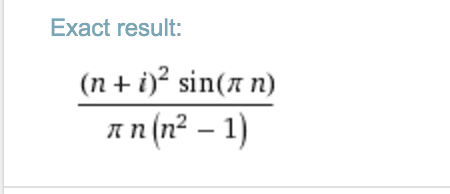

I started off by analyzing the c_n by inputting f(Φ) = 1+2sinΦ
we get that the integral =

If [itex]u(r,\phi) = \sum_{n=-\infty}^\infty c_n R_n(r) e^{in\phi}[/itex] and [itex]f(\phi) = \sum_{n=-\infty}^{\infty} c_ne^{in\phi}[/itex] then [itex]R_n[/itex] is the solution of the boundary value problem [tex] \frac{1}{r}\frac{d}{dr}\left(r\frac{dR_n}{dr}\right) - \frac{n^2 R_n}{r^2} = 0[/tex] subject to [itex]R_n(1) = 1[/itex] and [itex]R_n'(r_0) = 0[/itex], obtained by substituting the series definition of [itex]u[/itex] into Laplace's equation and considering the coefficients of [itex]e^{in\phi}[/itex].
Now there are two points to note:
(1) The BVP for [itex]n > 0[/itex] is the same as that for [itex]-n < 0[/itex] and therefore they have the same solution: [itex]R_n = R_{|n|}[/itex].
(2) The BVP for [itex]n = 0[/itex] is a special case.
Thus we have [tex] u(r,\phi) = c_0R_0(r) + \sum_{n=1}^\infty (c_n e^{in\phi} + c_{-n}e^{-in\phi}) R_n(r)[/tex] which is easily rearranged into [tex] u(r,\phi) = c_0R_0(r) + \sum_{n=1}^\infty (a_n \cos n\phi + b_n \sin n\phi) R_n(r)[/tex] if that's more convenient, and I'll let you go back and solve the BVPs for [itex]R_n[/itex] for [itex]n \geq 0[/itex].

answer is u(r,Φ) = 1+2*((r^2+r_0^2)/ (r(1+r_0^2))) sinΦ
The Fourier series of [itex]1 + 2 \sin \phi[/itex] is, astoundingly, [itex]1 + 2 \sin \phi[/itex]. Substitute this into the general solution.
