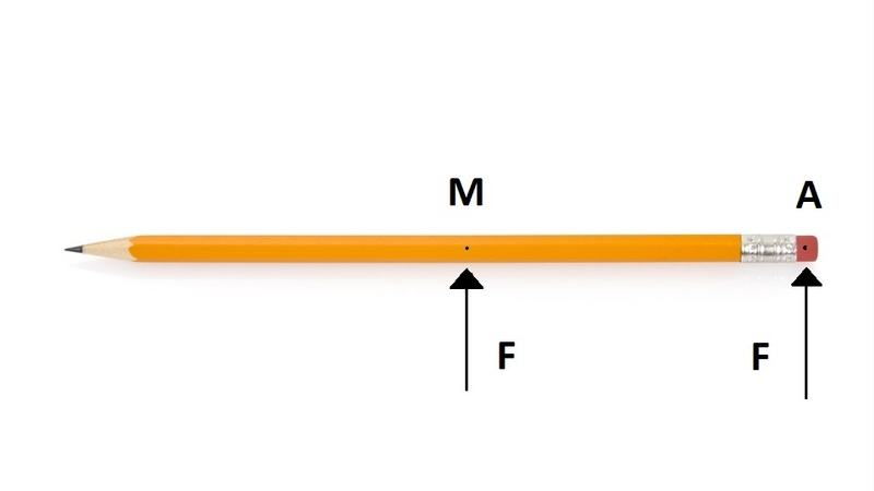

So here is the problem:
We have a pencil , horizontally towards us, sitting on a table(see the picture). There are no external forces applying on the system table-pencil and friction of air doesn't exist. There is also no friction between the pencil and the table.
So, we apply the same force F two times. The first time we apply the force on the point M (see the picture) which is the center mass of the pencil. The second time we apply the same force on the point A which is the edge of the pencil.The force is applied vertical on the pencil in both cases (see the picture).
Question:
The center mass of the pencil will reach the end of the table:
a) faster when F is applied on the center mass of the pencil , point M.
b) faster when F is applied on the edge of the pencil, point A.
c) at the same time in both cases.
So, I have argued with two of my high school physicists about this problem and both gave me a different explanation, but I disagree with both of them, so here are the two opinions of my teachers and my opinion.
I assume you mean horizontally, the picture being the view from above.
DimosNat said:
in both cases the pencil will only have linear kinetic energy
Clearly not. In the second case it will also have rotational energy.
DimosNat said:
ΣF=macm and because F is the same in both cases the
acceleration of the center mass will be the same.
Correct explanation. The preceding discussion of energies is true but does not constitute a proof.
DimosNat said:
in both cases F will produce the same amount of work W.
Only if F advances the same distance. In the second case the rotation of the pencil means the force will get to advance further.
Namely, in the second case F will produce more work in comparison with the first case ,because the pencil in the same amount of time t will advance the same distance d and will rotate θ rad.
So W1=E1=F*d
while W2=E2=F*d + F*(x/2)*θ
W1<W2
Is that right?
So W1=E1=F*d
W1<W2
Is that right?
Yes.
