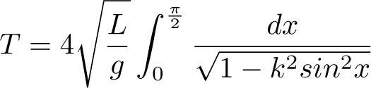

1. Consider a pendulum with length L that makes a maximum angle Θ with a vertical center line. The period T of this pendulum can be computed by the following integral
where k=sin(Θ/2) and g is the acceleration due to gravity. Find the period of this pendulum if L=1 meter and Θ=40º using Simpson's Rule with n=10
2.
3. So if I substitute 1 for L and 9.8 for g, I can multiple the integral by the constant in front of it. The problem I have is with the integral itself. Since k=sin(Θ/2), I can not see how to integrate with respect to x or Θ because they are both in the denominator of the equation. Can somebody please help me out with this by explaining what I should do ? I know the Simpson's rule formula but I am stumped how to apply it since I can not understand how to integrate with this formula ? All helpful advice is kindly appreciated !
you only need to integrate w.r.t. x, theta is a constant in this equation as it represent the maximum angle, 40 deg for this case, so you can treat k as a constant
what do you mean by integrate w.r.t. x ? I'm not familiar with that expression...
w.r.t. x = with respect to x
The presence of dx in the numerator tells you you're integrating with respect to x, not θ.
Simpson's rule is a method for numerically evaluating an integral:
[tex]\int_a^b f(x)\,dx \cong \frac{h}{3}\left[f(x_0)+4f(x_1)+2f(x_2)+4f(x_3)+\cdots+2f(x_{n-2})+4f(x_{n-1})+f(x_n)\right][/tex]
where n is the number of divisions, h=(b-a)/n, and xi=a+ih. This problem is pretty much just plugging everything into the formula and grinding out an answer.
thanks guys, I did as you said, split up the thing into the ten intervals and evaluated it at each, multiplied all of it by the gravity-pendulum constant in front and it came out to be 2.07~ seconds which the professor said was correct !
