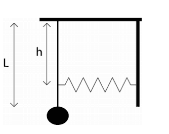

A 5kg sphere is connected to a thin massless but rigid rod of length L=1.3 m to form a simple pendulum. The rod is connected to a nearby vertical wall by a spring with a spring constant k= 75N/m, connected to it at a distance h=1.1 m below the pivot point of the pendulum. What is the angular frequency (in rad/s) of the system for small amplitude oscillations.

My final equation is
mL2[tex]\omega[/tex]2tex]\theta[/tex] = Lmg[tex]\theta[/tex] + k*h2*[tex]\theta[/tex]*(theta + [tex]\pi[/tex]/2)
The problem is that this gives me a [tex]\omega[/tex] that is dependent on [tex]\theta[/tex], which isn't possible. It should be constant. Can someone please tell me where I'm going wrong?

sin(theta+pi/2)= cos(theta). For small angles, cos(theta) =1.
