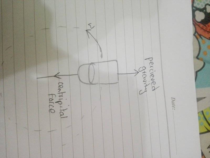

My teacher told me that this perceived gravity acts opposite to the centripetal force and this perceived gravity is the force which keeps water in the bucket when bucket is upside down.
My question is that if both forces are in opposite direction, why aren't they cancel each others effect so that bucket has no resultant force and why isn't the bucket moving in a straight path?

Have a look at this diagram where bucket is in circular motion. Why aren't perceived gravity and centripetal force cancelling out each other as they both are in opposite direction?

Have a look at post #3. The "perceived gravity" is called inertial centrifugal force, and exists only when you analyse the situation in a rotating reference frame. In the co-rotating frame the inertial centrifugal force does cancel the centripetal force, which is consistent with the bucket being at rest (having no acceleration) in that frame.

Note that, when you use the co-rotating frame, the object does move in a straight line (it stays stationary) just as you would expect when the fictitious force of perceived gravity cancels with the real centripetal force. Carnival rides such as the rotor or gravitron use this effect.
I'm adding what I consider a clarification. Say you have a rotating space station and an object on the floor of the space station. From an inertial (non-rotating, non-accelerating) frame of reference, you have a Newton third law pair of forces, the floor exerts an inwards centripetal force onto the object, and the object exerts an outwards force in reaction to the centripetal force (sometimes called reactive centrifugal force). The point here is that the object experiences a net inwards centripetal force from the floor.
Using the space station itself as a rotating frame of reference, the object is at rest with respect to the space station, not accelerating with respect to the rotating frame, so the object is experiencing zero net force. In a rotating fame, the forces acting on the object are the real inwards (centripetal) force from the floor, and the fictitious outwards centrifugal force due to the rotating frame of reference (it's not considered as a reactive force to acceleration, because the object is not accelerating with respect to the rotating frame). This is not a Newton third law pair of forces because both forces are acting on the same object.

Key is: In the inertial frame there is no opposing force.

Maybe to make it more clear for the OP: what he's suggesting is like saying the "ma" in f=ma is a second applied force that cancels the "f" and results in the acceleration. But no, the ma is just the other half of the force pair resulting from the acceleration; it's the reaction force.

Fictitious forces do not have third-law partners. The "centrifugal reaction force" is a real force that is the third law partner of the real centripetal force.
We are talking 2nd law here.
$$F_{real}=ma_{real}$$
$$F_{real}=m(a_{real}-a_{frame} + a_{frame})$$
$$F_{real}=m(a_{real}-a_{frame}) + ma_{frame}$$
$$F_{real}=ma_{relative} + ma_{frame}$$
$$F_{real}-ma_{frame}=ma_{relative}$$
$$F_{real}+F_{pseudo-gravity}=ma_{relative}$$
[Adopt a sign convention so that pseudo-gravity is a negative (downward-pointing) vector for a positive (upward-pointing) frame acceleration]
The mass of an object times the acceleration of the non-inertial frame of reference one is adopting manifests as a term that looks just like a force. It can be called "pseudo-gravity" if you like. But it is not a "reaction force".

I think you are hopping from one frame to another in your mind and that is giving you an apparent paradox. You can explain the situation in one frame by sticking to that frame - likewise for a different frame.
