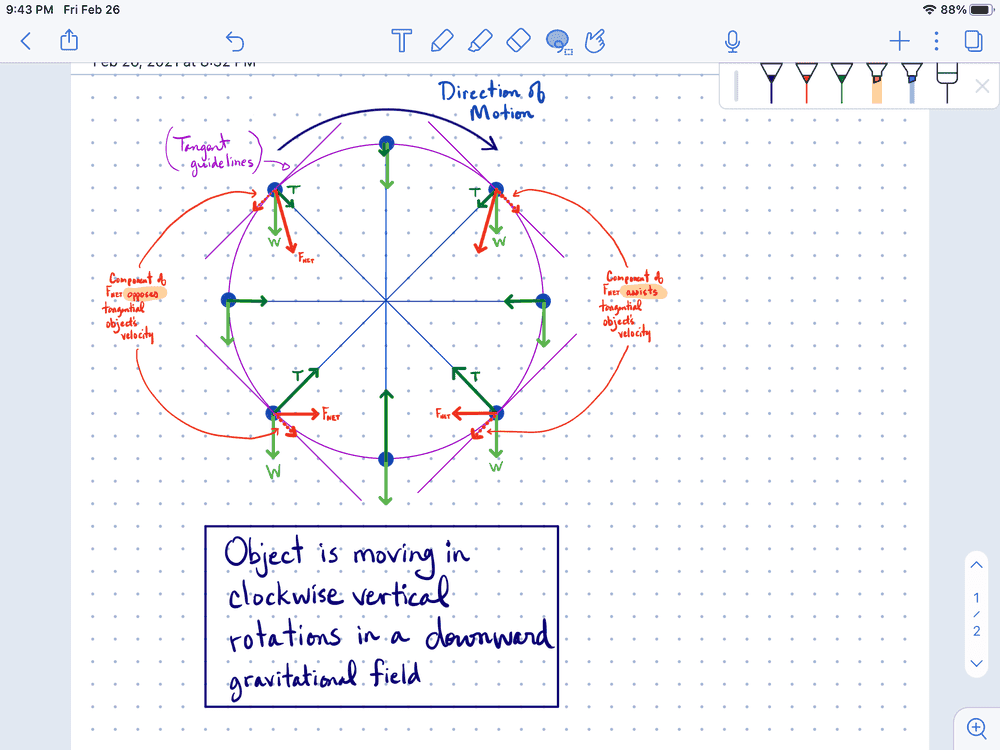

Thank you to everyone for your comments. I’m sorry I didn’t include a diagram earlier. I got home and finally had a chance to draw a diagram of what I mean.

Your diagram is faulty. You show two external forces, tension T (blue) and weight W (green). OK. Then you show net force FNet in red. Not OK. The net force must be the vector sum of the blue and green arrows, reasonably drawn to scale. It is not. Examples
At the due East position there should be a read arrow pointing down and to the left. There is none. Why not? Similarly at the due West position.
At the due North position again you show no red arrow. Why not? Both the tension and the weight point down, therefore their red arrow sum must also point down. Similarly at the due South position except that the blue and green arrows point in opposite directions. However, they cannot cancel each other out because there must be net centripetal force to make the mass follow the circular path.
Having said all that, I am not sure under what conditions you drew your diagram. One possibility is that the mass is given a good kick at the due South position and more than enough speed to go around the loop. The other possibility is that the string is replaced by a light rod with some kind of driving mechanism at the center that causes the mass to go around the circle at constant speed. That's the Ferris wheel analogue. The third possibility of a mass at the end of a string going around the circle of fixed center at constant speed is not a possibility for reasons that I explained in post #4.

Ok, so I will do my best to address each person's comment the best I can.
But, perhaps to start, I thought a visual example might be helpful to explain what I've seen before. I know there is a whole lot more going on with the physics on this example but I'm hoping the general idea will be seen. When we see gymnasts doing 'giants' on a high bar...
...it can be seen that they slow down at the top of their swing. In a thought experiment too - if one was to pump your legs hard enough on a playground swing and you could avoid having the chain becoming slack and falling down, one could swing so hard that you'd go right around. But, just beyond the minimum speed you would likely be slower at the top then speed up at the bottom. Of course, in this scenario you would need a different mechanism where the chains attach so they wouldn't wrap around.
For this diagram, I tried to think about the 2D vector addition and how long the Fnet would be. Though my scales are approximate I know it's not perfect. But the Fnet is supposed to be the sum of T and W is either is translated to the tip of the other.
I know also that I didn't draw in the Fnet for all positions of the rotating object (N, S, E, and W) But certainly these could be shown too. The only two which I'd think would not assist or resist would be the N and S.

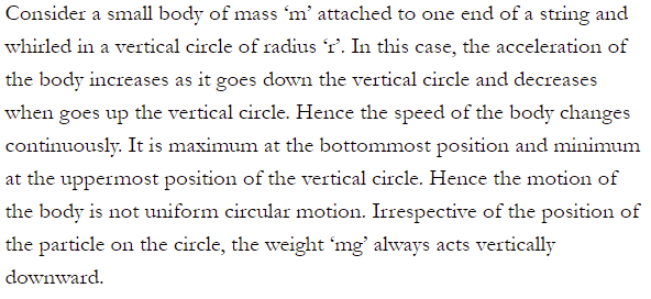

On this document practice problem #1talks about a ball swung in a vertical circle at 5 m/s. And on this page if one searches for the word 'constant' it appears four times with the context being vertical circular motion and objects going at a constant speed.
From the linked page:
It is "whirled", so it doesn't just move unter gravity. It also states that the speed changes.
A.T. said:
...It also states that the speed changes.
Hey that's right A.T., your right! I didn't see that before. Very cool - so it does say something about this. And from my own reference too.

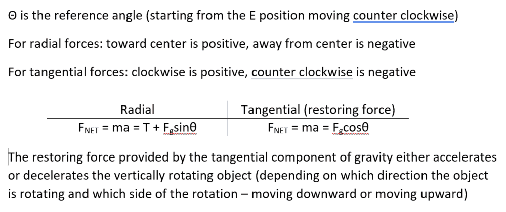

Hello Chestermiller, I've given the problem some thought and here's what I've come up with.
How does this seem to you?

Very good. So we have$$mr\left(\frac{d\theta}{dt}\right)^2=T+mg\sin{\theta}$$and
$$mr\frac{d^2\theta}{dt^2}=-mg\cos{\theta}$$
Do you agree?

Yes, I think I see it. Thank you Chestermiller, this has certainly helped me see the vertical case of circular motion with better clarity. It's been 25 years since I've done any calculus so I had to watch a video relating to the proof, but I think I got it. Thanks again for getting me to think deeper.
