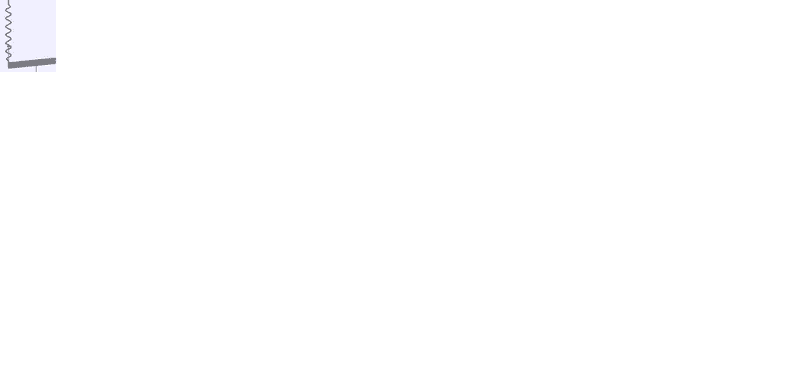

Sorry I can't attach the real figure but the figure below is really similar to the figure given in the question
so the rod is supported on a pivot under its centre, and the spring is attached to one end?
but then why does the question give a torsion constant (torque per angle, measured in Nm per radian), instead of an ordinary spring constant (force per distance, measured in N/m)? :confused:

Ops sorry my bad. It should be 2000 N/m. And for the figure, there is no support at the center of the rod. I crop the figure from internet and the line in the middle actually has downward arrow and is describing the weight of the rod. Sorry for the confusion :redface:

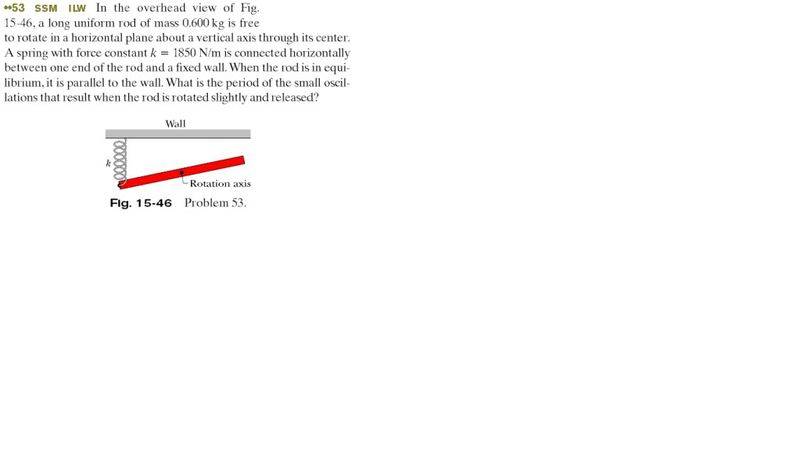

I found a very similar problem. Hope this attachment can clarify everything. Sorry :smile:

but that picture does show a pivot through the centre of the rod
(and there wouldn't be "small oscillations" about the horizontal position if there wasn't!)
sooo … are we to proceed on the basis of a similar pivot in the original question? :smile:

Let proceed with the question in the attachment because I am afraid that I typed the original question wrongly (I don't have the original question, the book has been taken :shy:)
Actually I still don't understand the movement of the rod. The rod will move up and down or back and front?
up and down :smile:
(so the spring stays vertical, there's no torsion)

This is the question we are dealing with :smile:

hmm … i don't like it when people use a formula that may or may not work :redface:
it's always safest to start from the basic equation
for shm, you're looking for a formula (valid for small x) x'' = -kx …
in this case use torque = spring force x distance = Iα …
what do you get? :smile:
(btw, your I must always be about the centre of mass or the centre of revolution … in this case, the same :wink:)

So, spring force x distance = Iα. Where should I take the pivot? At the center of the rod?
Let that be the case, then:
F sin (pi/2 - θ) . distance = Iα (I take θ to be the angle between the rod and horizontal)
kx cos θ . 1/2 L = 1/12 ML2α
I am not sure I get it right till this part. What to do with α and cos θ?

correct :smile:
for "small oscillations", you can assume cosθ = 1 :wink:
eliminate x by using x = (L/2)θ …
that gives you an equation of the form θ'' = - kθ ! :smile:

OK so:
k . L/2 θ . 1/2 L = 1/12 ML2α
α = (4k/M) θ
Then 4k/M = ω2 --> solve for period. Am I correct?

yes, except the euqations should all have a minus, and isn't that 4 a 3 ? :redface:

How can you get x = (L/2)θ? By looking at triangle formed by the horizontal, the rod, and vertical distance between center of rod and horizontal?
Yes, it absolutely should be 3 :blushing:
And about the minus sign, both side have minus sign because spring force is restoring force so it should be minus and the rod rorates clockwise so the angular acceleration should be minus?
yes :smile:
