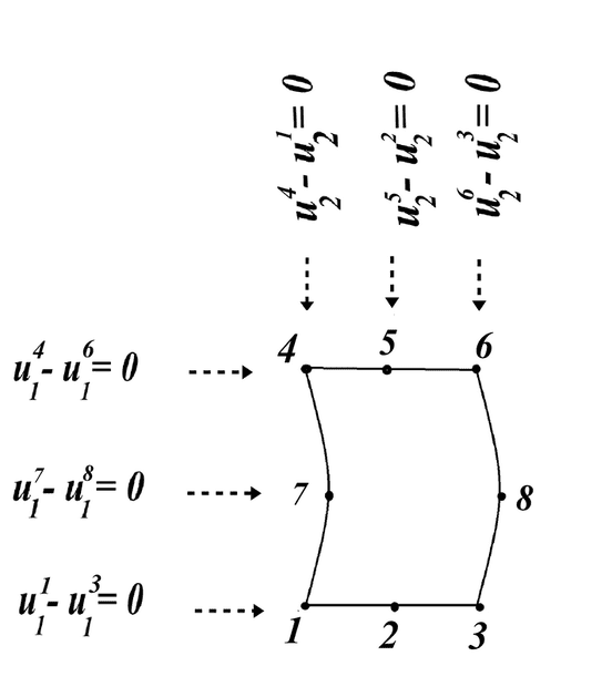

But I can try it again. So the underlying equations of periodic boundary conditions are as follows:
Source: https://www.physicsforums.com/threa...-workbench-modal-analysis.985108/post-6317474
So if look at these equations isolated: If u1 = 0 than u3 should be 0 as well. This would be the case if Node 1 was a fixed support.
But, if I combine the equations (e.g. the bottom two on the left) something like this results:
u1-u3=u7-u8.

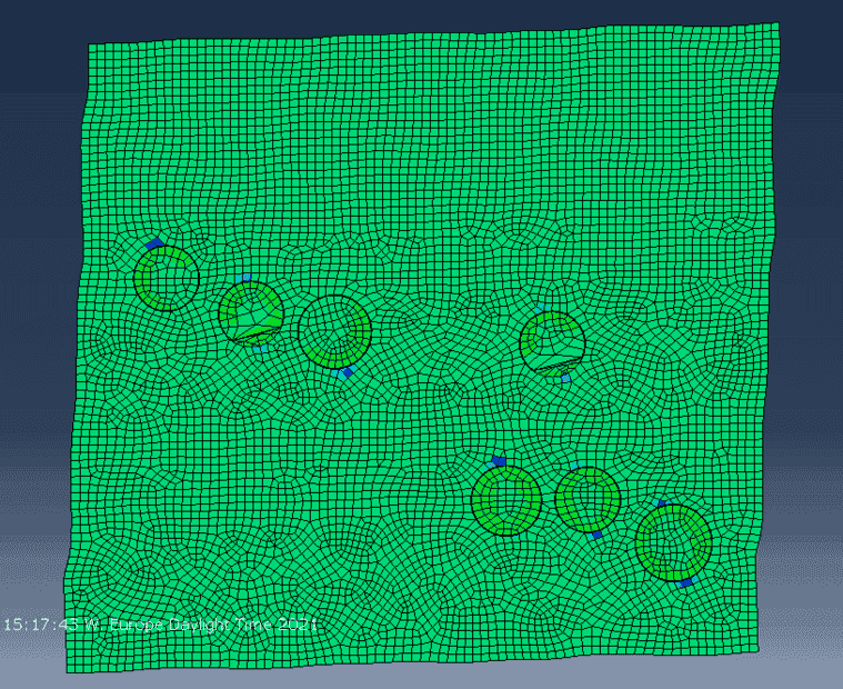

Now you set u1 = 0 and apply a displacement constraint to Node3 (which represents the applied load). If these combined equations are implemente in Abaqus it does result in periodic deformations, so it works. As an example (just for demonstration purposes) a combined shear/tensile load (the bottom left node is a fixed support):
But the underlying equations now don't seem to valid anymore (to my mind). And I can't figure out why. What these combined equations seem to do is couple the corner nodes to the internal nodes. But for some reason, I can't wrap my head around the logic behind that (or how it works)

In practice, RVE is more common than REV. The former stands for Representative Volume Element.
The goal of this equation constraint in Abaqus is to equalize displacements in a selected DOF for two nodes/node sets. And if you want to apply prescribed displacement then you could do it as it’s described in that older thread you cited.
Check the output files generated during this analysis, Abaqus may warn you about some conflicting comstraints and tell you how ot handled them.

NewStuff said:
I basically want to apply combined shear and tensile loads (not necessary via displacement). If I only couple opposing nodes, how do I then introduce the load? Via forces? And how do I support the RVE?
Check the Micromechanics plugin for Abaqus, it automates the process of RVE definition and allows you to apply various driving fields, including strain.
NewStuff said:
Which specific file should I look at? The .log files of the Jobs do not show any error messages.
Warning messages can be found in .dat and .msg files.
