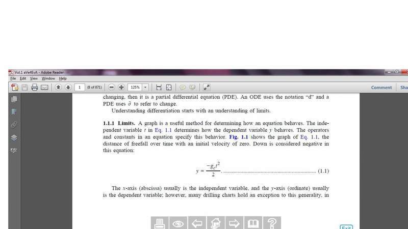

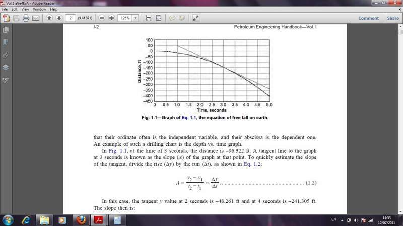

Hi guys. I am having trouble with my petroleum engineering course. I have attached the example that's giving me problems, start at 1.1.1 limits and just read through to the second pic where it states that the graph at 3 sec shows a height of -96.522ft and at 2 and 4 secs the height is at -48.261ft and -241.305. Am I missing something here? I have no clue where these numbers came from. there's a formula on pic 1 but I can't seem to get the same answers and also from the graph the heights are not coinciding with time. This is a renowned handbook that pro's use so it's not a mistake. Any help appreciated!

Well, I'm going to bet that, even though it is a renowned handbook, there's a mistake. I don't see where the -96 is coming from. It looks more like -150. The -48.261 and -241.305 coming from reading where the tangent line intersects the t = 2 and t = 4 lines, but the six-figure accuracy is ridiculous. You'd be hard-pressed to get two figures from these graphs.
I think the only mistake is in the sentence:
In Fig. 1.1 at the time of 3 seconds, the distance is -96.522 ft
If should really state:
In Fig. 1.1 at the time of 3 seconds, the slope is -96.522 ft/s
Then, they continue to state how the can calculate the slope of the curve at 3 seconds by using the 2- and 4-second points and doing (y2-y1)/(x2-x1) ...but these x's and y's are those of the straight line, not the curve.

First of all, you're awesome. Secondly, shouldn't dy/dt=-32.174t as apposed to y? so actually velocity=-96.522ft/s and not distance?

Ah! Yes, I'm sure you're right.

Here you lose me. First, the equation of a line is y = m t + y0. If the slope of the line is -gt, then at t=3 m = -3g, and the equation of the tangent is y = (-3g)t + y0. Second, you can't assume y0 = 0. It is obviously about 48.
And so, having this last equation and substituting gravity, y = -32.174t and so, it is not ridiculous to say that at 3 seconds, y = -96.522 ...nobody said that they read the number from the graph...it came from the formula.
Oh, come on. y at 3 sec is not -96.522, or anything close to it. Whether it came from the formula or a graph, the statement that y is -96.522 is WRONG. I think your first idea was right: they said "distance" when they meant "slope".

No, y = -gt is not the derivative equation that indicates the slope at any given time. The equation that indicates the slope at any given time is dy/dt = -gt. This is not a trivial difference.
