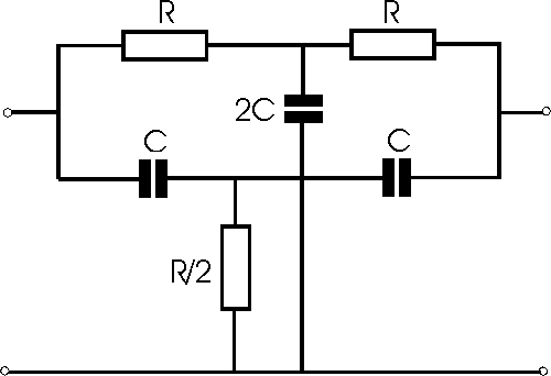

The harmonics are easier to analyse if the fundamental can be attenuated. I made a piggyback mains plug that contains a twin-T notch filter. The output coaxial cable goes to an oscilloscope with FFT analyser. There are voltage clipping diodes on the output to protect the oscilloscope from on/off transients.
The step-down transformer will generate harmonics. It is better to use a potential divider made from a chain of RC parallel elements, all with the same time constant.
Twin-T filter:
This filter can be improved with some feedback:

The traditional way of doing THD is to apply the signal to a RC network having a deep null, such as a Wien Bridge or Bridged Tee. The network is carefully tuned to the signal and all that remains is harmonics.
The higher Q is not needed in this case as the harmonic attenuation and phase will be predictable. The deep null is important, the Q is not.
The other problem with high Q is that if the fundamental voltage changes, or there is a voltage transient on the supply, the twin-T will ring and keep ringing at the fundamental frequency. With a Q of 100 the ringing will continue for a few seconds.
Avoid op-amps where mains voltages may be present. Reduce the voltage by removing the fundamental rather than attenuating the harmonics also.
