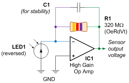

Hello, I would like to measure power from a photodiode. How do I go about doing this? What would the circuit look like?
To measure power from a photodiode, a current-to-voltage converter circuit using an operational amplifier (op-amp) is essential. This circuit operates the photodiode at zero voltage to measure the short circuit current, which correlates to the photon flux received. Calibration is necessary to convert this current into power, requiring knowledge of the laser's wavelength. An optical attenuator may be needed for high-output lasers to prevent damage and ensure accurate readings.

The traditional circuit is a current-to-voltage converter with an opamp:lcr2139 said:I would like to measure the power of a laser through a photodiode, i mean.
