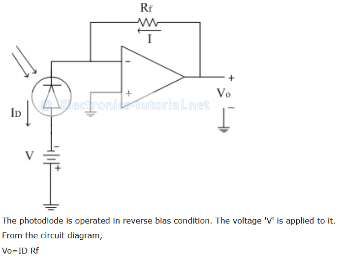

The PD is a high impedance current source, so the resistance you terminate it into determines the voltage level you will detect.
It might be possible to use a current mirror circuit to do a better job of detecting these small PD currents, but the best way is to use a good-quality preamp after the DC blocking circuit. The way that I usually implement photodiode detectors is with a negative voltage for the reverse bias...
https://www.electronics-tutorial.ne...current-to-voltage-converter/#google_vignette

1) What I understand is that there are two terminations: one at the scope with high impedance, and the other at the 50 Ohm termination with low impedance. If this is correct, why does the low impedance affect much even in the presence of the high impedance which is used for the detection?
2) If I need a reverse bias operation, should I build my own circuit? I think that's too much thing for me... I am not confident enough to make a precise measurement circuit that is required on my experiment.
As you said, I am trying to do the best way, making a working DC blocking circuit before the preamp, and that's why I want to figure out how to make it. I actually tried to amplify the PD signal with/without DC blocker, and it didn't work for both cases. They didn't show any signal just like what's shown in the current DC blocking setup. I just want to know why the signal disappears.
