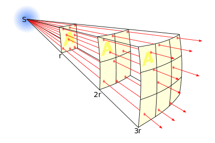

Ok. Let me put it this way: why are not rays infinitely dense? If you look at the picture below at any two rays, why are there not infinitely many rays between them? Is it due to Planck scale, or something like that?

Because each emitter can only output a finite amount of radiation. As the wavefront expands the energy is spread out more and more. The picture merely illustrates this using a few rays, as drawing hundreds or thousands wouldn't be possible. If you want to represent each ray as being one photon, then any real source would not put out an infinite number of photons.

Light rays are a conceptual device, not physical objects. The intensity of the light falling on a surface (typically measured in watts per square meter) is proportional to the number of rays per unit area at that surface, but you're free to make the proportionality constant whatever you like, so long as you're consistent about it.

For clarity's sake, please note that the "pieces of paper" in this image are not flat.
