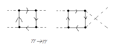

Is it possible for photons to interact with each other directly?
No.
There is only one photon-photon-graviton vertex, but that is exceedingly small. Photon photon scattering is dominated by fermion loops.
If photons can't couple with other photons , And if they obey the principle of superposition , when we fire photons through a double slit , then how are they interacting with each other , I have only begun to study QM so take it easy.
Yes, but the OP said "directly" - I would argue this excludes fermion loops.
I agree, "directly" excludes fermion loops or non-linear effects in active materials.

You can't exclude loops from tree level interactions in a meaningful way. A physical interaction will include all contributions, splitting them up in tree level and higher order loop contributions is unphysical, even though in perturbation theory the contributions appear separately. Well known example: You can have violations of unitarity at tree level while in reality no such violations are possible within quantum mechanics as it is a unitary theory by design.

The question was if photons can interact. The answer is: not directly, only via fermion loops. And interference is not to be confused with interaction; it is a different phenomenon that applies already to single particle states.
