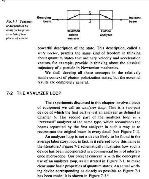

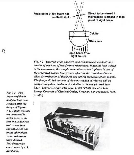

  • #75
DrChinese said:
Sure, here is a diagram which shows what I am referring to, and a reference to where it originated:
http://www.pas.rochester.edu/~AdvLab/Eberly_Bell_Inequalities_AJP.pdf
"We employ an arrangement of polarization analyzer loops to derive several simple Bell inequalities and then discuss the violation of one of them in light of quantum and classical interpretations of the data recorded."
This is definitely not relevant to BSM!
Simply count the inputs.
BSM - 2 inputs, 2 outputs
This example - 1 input, 2 outputs that are then recombined into 1 output again.
Yet another difference is that in this example beam is split using PBSes but BSM is done using polarization independent BS.
