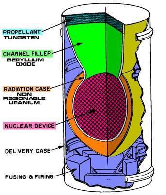

Another thing worth mentioning is that nuclear warheads can be improved by sheathing them in different materials that add to their effects. For example, they could be made to scatter radar-absorbing particles over a wide radius for improved jamming efficiency, and such particles could linger for some time.

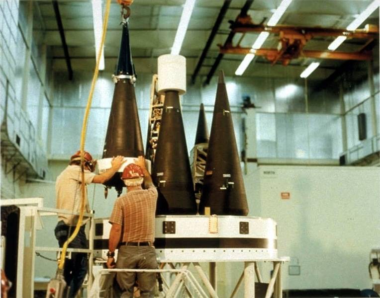

Considering we already have MIRV missiles that separate into 14 independently targeted re-entry vehicles each, is that really an obstacle? Just launch 10 of those and you've got a 140-missile Itano circus.
