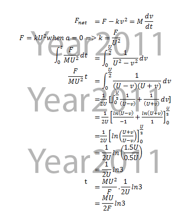

These workings were presented to me by a user of another forum:
I don't get the third line :(
ARGH I feel so stupid LOL.
k = \frac{F}{U^{2}}, so from first line,
F \left( 1 - \frac{v^{2}}{U^{2}} \right) = M \frac{d v}{d t}
\frac{F}{M U^{2}} = \frac{1}{U^{2} - v^{2}} \frac{d v}{d t}
Integrating,
\int_{0}^{t} \frac{F}{M U^{2}} dt = \int_{0}^{\frac{U}{2}} \frac{1}{U^{2} - v^{2}} dv
which is the third line.

Hi I get it already, thanks :D
