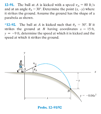

Textbook diagram of a ball kicked from point A at angle θA with initial velocity vA, following a parabolic arc to point B on a downward-sloping curve labeled y = -0.04x², with axes x and y and the vertical drop labeled -y.

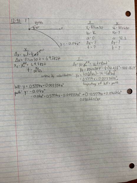

Handwritten physics derivation on lined paper for problem 12-91: a ball launched at 80 ft/s, 30 degrees above horizontal, with a sketched parabolic path labeled y = -0.04x^2, and x and y equations of motion in columns, ending with the trajectory y = 0.5774x - 0.003354x^2.
I am honestly stumped at this point. Online solutions say that my equation y = 0.5774x-0.003354x^2 should instead be -y = 0.5774x-0.003354x^2 since "the change in y is negative"...
However, would the value y just be solved to be a negative value if all calculations are done correctly? I used a graphing calculator to check as well and the function, y = 0.5774x-0.003354x^2 is extremely different from how I imagine the projectile motion of this ball to look. Did I make a mistake somewhere while eliminating the parameter t from the equations? Or was there an assumption I made in solving that cannot be made? Thank you for the help in advance :).
Your approach is correct, however your expression -0.04x2= 0.5774x -0.003354x2 troubles me because its non-zero solution is negative and that can't be. Probably you made a mistake somewhere in your calculation of all these numbers.
Try solving it using symbols all the way to the end. Then substitute the numbers at the very end. A symbolic representation of the answer would be easier to troubleshoot. Start by writing ##t=\dfrac{x}{v_0\cos(30^o)}## and replace that in ##y=v_0\sin(30^o) t-\frac{1}{2}gt^2## for starters.

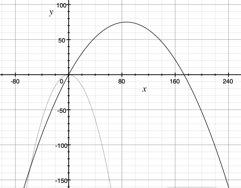

That is curious. ##y## would go negative after ##\approx 172 \rm{ft} ##, but if you try to solve it as
$$ -0.04 x^2 = \tan \theta x - \frac{1}{2}g\frac{x^2}{v^2 \cos^2 \theta} $$ which seems like the LHS must be a negative value you run into some issues. The method of factorization in the solution seems to be choosing the undesirable root that you would get plugging a negative value for ##y##
$$ x \left( \tan \theta + \left( 0.04 - \frac{1}{2} \frac{g}{v^2 \cos^2 \theta} \right)x \right) = 0 $$
When I solve that I get a solution for ##x## which is negative and far too small? Strange.
When ##y = 0 ## for the ball at ##x=172 ft##, the hill is 1,183 ft below the ball
$$y_h = -0.04 x^2 = -0.04 \cdot 172^2 = -1,183 \rm{ft}$$
Something is off. I'm pretty sure this means the ball never touches the hill using these figures (except at the origin).
erobz said:
Something is surely off. Is it possible with these numbers the ball never touches the hill?

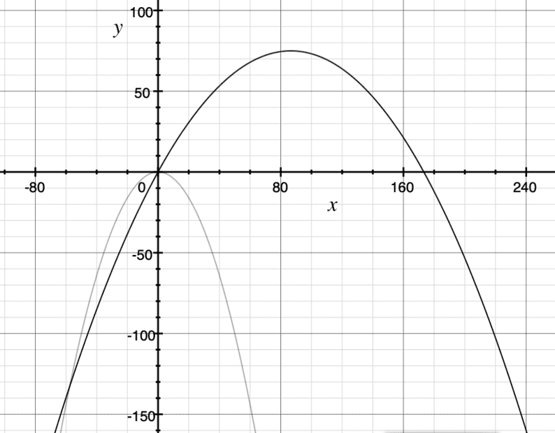

Yes. Here is a graph of the two parabolas. It seems that the numbers are bad.
Graph of two downward-opening parabolas plotted against x and y axes, both passing through the origin; the black curve peaks near x = 85, y = 75 and crosses the x-axis near x = 170, while the grey curve is steeper and falls below the axis.

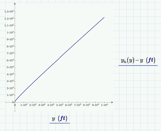

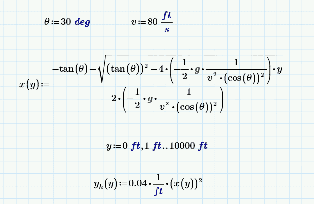

Mathcad worksheet defining theta = 30 deg and v = 80 ft/s, a formula for x(y) involving tan(theta), g, v and cos(theta), y ranging from 0 to 10000 ft, and y_h(y) = 0.04 ft^-1 (x(y))^2.
There is the ##x## coordinate of the ball as a function of its height below the datum, ##x(y)##.
##y_h## is the hill elevation below the datum
Here is a plot of ## y(h) - y ## vs ##y##:
Line graph of y_h(y) minus y in feet against y in feet, both axes from 0 to 10^4 ft and up to about 1.3 x 10^5; a dark blue curve rises nearly linearly from the origin to roughly 1.2 x 10^5 at y = 10^4.
The difference between them appears to be increasing without bound.

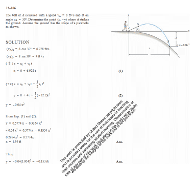

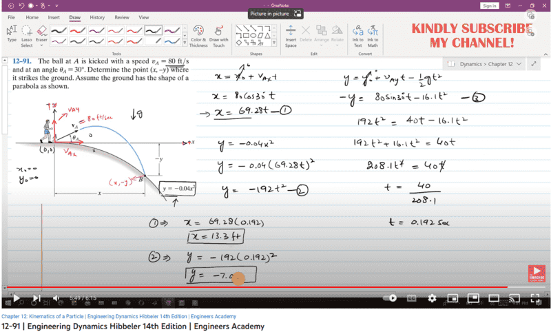

Apparently, this is problem 12-91 from Engineering Dynamics from Hibbler 14e with initial speed 80 ft/s.
But from a solution I found online from a similar problem 12-106 from 13e has the initial speed of 8 ft/s.
I think it's a typo or else a poor attempt to change the input.The following "solution" obtains a number... but, as many of you have found,
the projectile trajectory with the given numbers doesn't match
the diagram shown in the image
youtube.com/watch?v=AZd9iCK8IuE
Screenshot of a video solution to Hibbler problem 12-91: a ball kicked from A at 80 ft/s and 30 degrees, with a parabolic hill curve, and handwritten equations for x, y and t, ending with x = 13.3 ft and y = -7.0 ft.
vs.
issuu.com/manaren/docs/engineering_mechanics_dynamics_13th
Solution page for problem 12-106: a ball launched at 8 ft/s and 30 degrees up a parabolic hill, with equations for horizontal and vertical motion, yielding x = 1.95 ft and y = -0.153 ft.

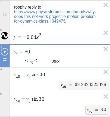

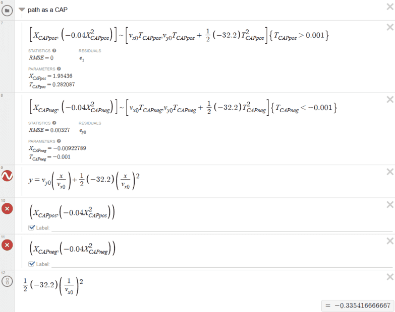

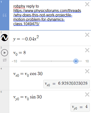

To see what is going on, I made a desmos file
to solve the problem with various combinations.
https://www.desmos.com/calculator/t14gpeohny

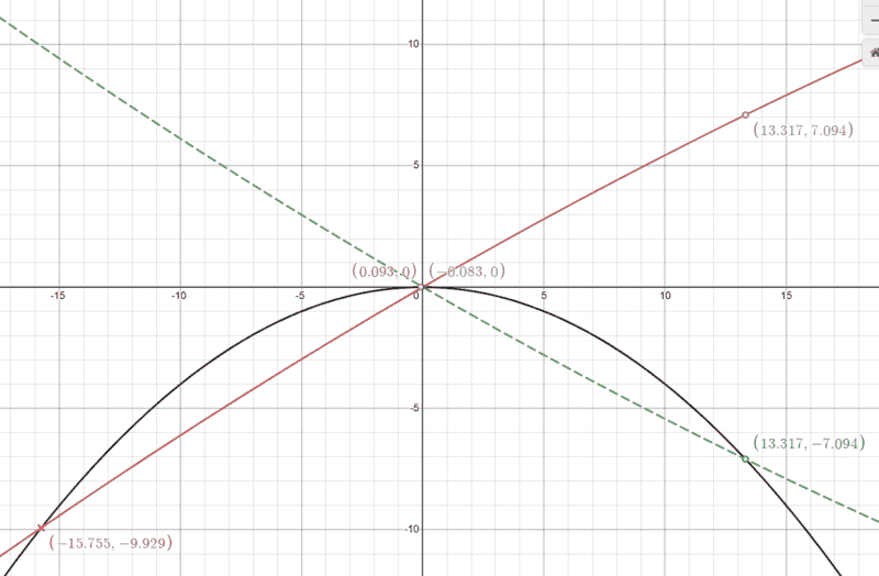

The parabolic hill is in black.
The physical trajectory is the "CAP"-parabola in red.

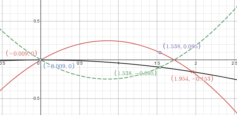

This is for 8 ft/s (12-106 in 13e)
Desmos graph of a black parabolic hill, a red downward-opening parabola, and a green dashed upward-opening parabola on x from -0.5 to 2.5 and y from about -0.6 to 0.7, with labelled intersection points at (-0.009, 0), (1.538, 0.095), (1.538, -0.095) and (1.954, -0.153).
This is for 80 ft/s (12-91 in 14e).
The "solution" uses the unphysical green-dashed CUP-parabola (with the (-y) nonsense).
Note that one must zoom out.
Desmos graph with a black downward parabola peaking at the origin, a red upward-sloping line through the origin, and a green dashed downward line; labeled points include (13.317, 7.094), (13.317, -7.094), (-15.755, -9.929), (0.093, 0) and (-0.083, 0).
DETAILS:
I used desmos's regression to solve a system of equations.
  • For 8 ft/s (12-106 in 13e), the correct solution is ##X_{CAPpos}=1.95 ft##.
Desmos calculator panel listing y = -0.04x^2, v0 = 8 with a slider from -10 to 10, vx0 = v0 cos 30 = 6.92820323028, and vy0 = v0 sin 30 = 4.
Desmos calculator screenshot titled path as a CAP: regression fits and parameters for two parabolas, the equation y = v_y0(x/v_x0) + (1/2)(-32.2)(x/v_x0)^2, and a final value of -0.335416666667.

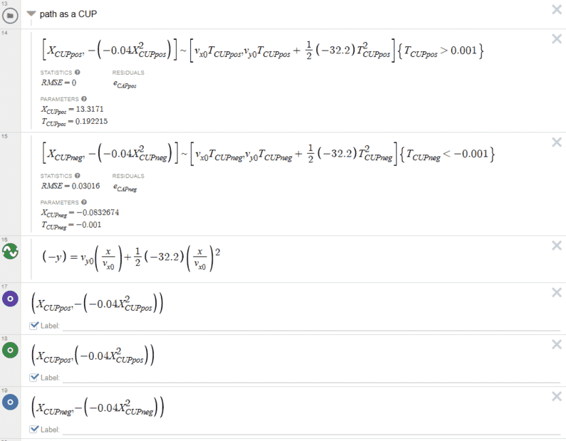

  • For 80 ft/s (12-91 in 14e) , (there is no physical solution),
    but the incorrect "solution" gets their value for ##t>0## as ##X_{CUPpos}=13.31 ft##.
    by using the unphysical CUP-parabola in green.... from the (-y) nonsense .
    Desmos calculator entries: reply header with a forum link, the equation y = -0.04x^2, the variable v0 set to 80 with a range and step inputs, vx0 = v0 cos 30 evaluating to 69.2820323028, and vy0 = v0 sin 30 evaluating to 40.
    Desmos calculator screenshot titled "path as a CUP" listing regression fits: X_CUPpos with RMSE 0, parameters X_CUPpos = 13.3171 and T_CUPpos = 0.192215; X_CUPneg with RMSE 0.03016, parameters X_CUPneg = -0.0832674 and T_CUPneg = -0.001; an equation (-y) = v_y0(x/v_x0) + (1/2)(-32.2)(x/v_x0)^2; and three plotted expressions in lines 17 to 19.
So, as I said,
