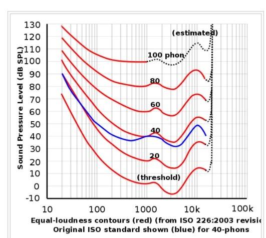

https://en.wikipedia.org/wiki/Loudness said:
In acoustics, loudness is the subjective perception of sound pressure. More formally, it is defined as, "That attribute of auditory sensation in terms of which sounds can be ordered on a scale extending from quiet to loud."
The relation of physical attributes of sound to perceived loudness consists of physical, physiological and psychological components. The study of apparent loudness is included in the topic of psychoacoustics and employs methods of psychophysics.
In sound systems it sounds like the subjective definition applies. If so, then amplitude is not enough.

If I keep everything else constant - Ambient noise value, temperature or anything else that could change behavior of sound - But the amplitude of wave, will it change the loudness of what I was hearing so far?
