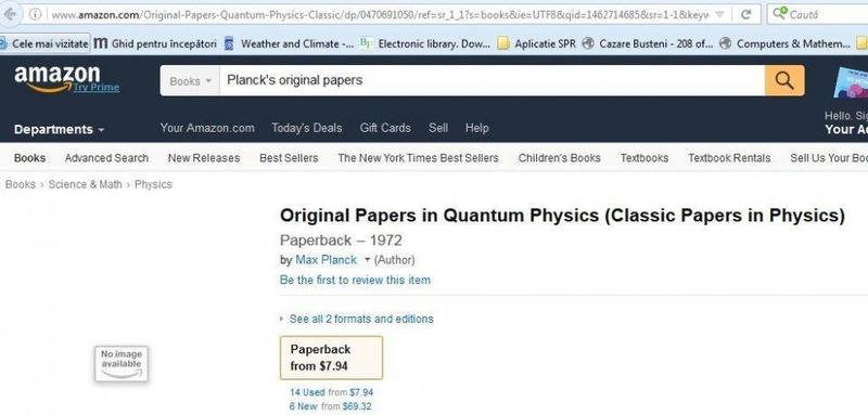

You can find the two original papers of Max Planck to the German Society of Physics (DPG) from October and Dec. 1900 in this old book: https://www.amazon.com/dp/0470691050/?tag=pfamazon01-20 - both in English translation and German original. You can also check Gallica (the digital Library of France) for the mentioned volumes of Annalen der Physik from 1900 and 1901.
For some unkown reason the Amazon direct link is not working.
