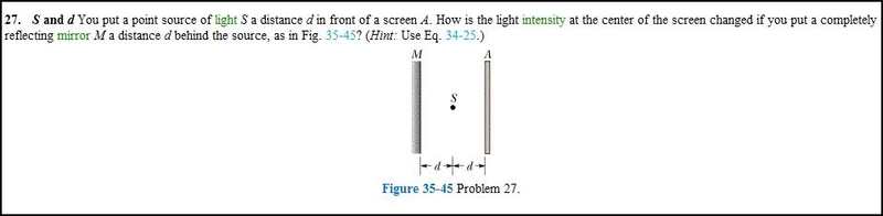

I'm having problems doing the problem below. The equation in the hint is: I = Ps/(4*PI*r^2) which I have not clue how it relates to this question except for that it's an equation for intensity.
I know that there will be a image produced a distance d behind the mirror, so there will be another "light source" 3d away from the screen.
We define intensity as
[tex]I=\frac{P_{power}}{A_{rea}}[/tex]
If we assume that the source is pointlike, the intensity will spread like a sphere from the source. [tex]4\pi \ r^2[/tex] is the area of a sphere with the radius r. The intensity at the distance r from a pointlike source is thus
[tex]I=\frac{P}{4\pi \ r^2}[/tex]
Does that help?
(I noticed that in your formula you don't have the radius squared. Are you sure that it isn't squared in your book? This is how I would interpert the formula, might be I am wrong)
oops thanks for pointing out the typo but I still don't understand what power has to do with this problem.

Hi DANIELLYMA! :smile:
It doesn't really matter what power has to do with the problem …
you're only asked to say how the intensity changes
use the formula to calculate by what proportion it goes up because of the "extra" source :wink:
r is the radius of the source, how do I take into account the the 3d distance from the screen?

I don't follow :confused: … r is distance.
