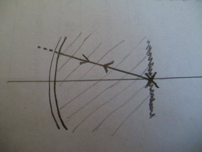

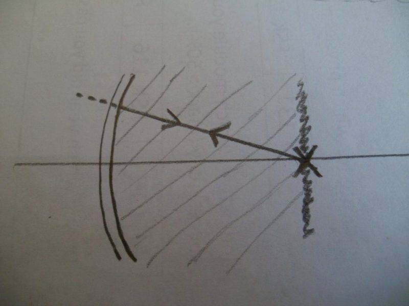

Is it correct?
I can not draw ray diagrams for the second one (105 cm).
I think at the block mirror interface one would get refraction both ways which leads to complications.
Assume a slight separation between the block and mirror to draw the ray diagram.
Slightly big separation but is it ok?
Volcano said:
Is it correct?
more or less correct... only the curvature of mirror should be circular and the rays are radial so that its a normal incidence making an angle 90 degrees with the element of the surface -tangential at the point of incidence.
so one does not get refraction -only the light rays will be moving slower; the surface of the medium is also spherical and rays are coming out at centre of curvature.

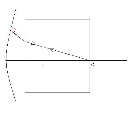

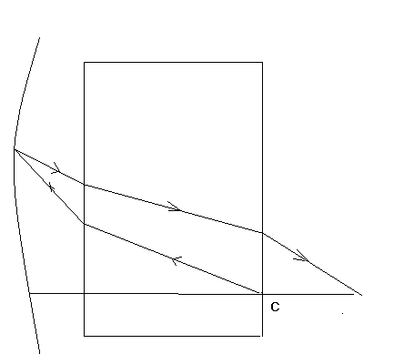

It seems it does not make a difference to the problem whether there is a thin separation or not. Due to the symmetry of Snell's law the beam still ends up being reflected back at the original incident angle inside of the block.

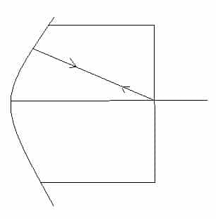

Is this?
(Sorry, I'm taking your time)
More like this since the beam arrives along the normal to the surfaces
Ah! I got it. You meant that the separation between the block and mirror should be parallel to both surfaces. Thank you very much. Greatly apreciated.
