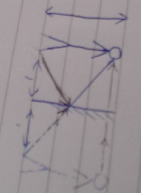

15. What is the minimum length of a plane mirror in order for you to see a full
view of yourself?
A 1/2 your height B 1/4 your height
C 3/4 your height D your full height
Q Why is answer of A given is the correct one,
angle of incidence = angle of reflection
view of yourself?
I understand pictorially how it is, since visually if you were to draw a mirror of the same length as the man, and draw the virtual image produced
you will see the reflected ray of light coming from the feet, emerge halfway up the mirror approximately en route to the real object (the man).
(Image explaining this is attached)
But is there not a more mathematical/geometrical way of explaining how A is so?
Hi @User1265 and welcome to PF!
You can use a geometric description in which there are two similar right triangles. The base of the smaller one is the length of the mirror and its height is the distance from the mirror to the object. The base of the larger one is the height of the image and its height is the distance from the image to the object. Use the relation that you know about similar triangles to derive an expression for the ratio of the bases in terms of the ratio of the heights.
Does it matter that your eyes are not actually at the top of your head?
Yes there are many (similar triangles, Fermat's Principal, wave interference) but what I carry around in my head for this is essentially a little sketch on crumpled paper. Why do you want a more "mathematical" description?
