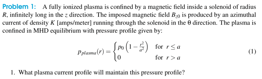

See Attached file
See Attached file
∇p=j×B (eq. 1)
K=nI
BSolenoid=μnI⇒μK (eq. 2)
∇p=-2p0r/(a2) (eq. 3)
Combining these three equations:
j=-2p0r/(a2μK) (θ hat direction)
Feel like this is too simple and might be missing a step any help would be much appreciated!

Your work looks correct to me.
