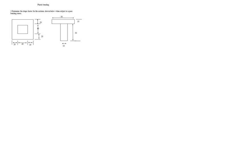

I have attached a jpeg of the question invloved. Involving finding shap factors for both the T and the sqaure piece.
Due to illness i missed the lecture for this topic and as such i am missing the relevant equations on how to attempt this. If osmeone knows how to start to attempt this i would much appreciate it.
So far i don't know how to start the question,
  • Two cross-section diagrams for a plastic bending problem: a square with a square hole, outer side 80 with a central hole 40 wide, and a T-section with a 30 wide flange 10 thick over a 10 wide web 30 tall.

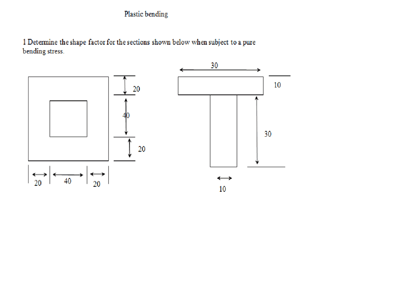

Third time lucky i hope
  • Worksheet titled Plastic bending with question 1 to determine the shape factor of two sections under pure bending; left, a square section with a square hole, dimensions 20, 40, 20 on each side; right, a T-section with flange width 30 and thickness 10, web width 10 and height 30.
You need the ratio of the plastic section modulus to the elastic section modulus. For the plastic section modulus, you should be able to find the equal area axis, and then take the first moment of area about that axis, paying no attention to sign. Try posting your attempt for better help.
