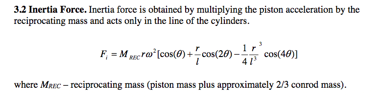

jaguar57
I need to know what the w is in this formula.
Also I am not 100% sure which angle it is using.
This is for figuring the inertia of the piston assembly in a 2 stroke engine.
thanks

Hello jag, :welcome:
I'm pretty sure the ##\omega## is the angular speed of the crankshaft and ##\theta## is its angle. If you could provide some more context, maybe we can settle this with more certainty.
thanksView attachment 226566
The w is the lower case Greek omega: ##\omega##. It is usually used for angular frequency which in SI units is measured in radians/second
Since cos(0)=1 and cos(90)=0 then I guess I can assume that the angle of the crank is from the horizontal axis since near 90 and 270 degrees (assuming o degrees is with the piston at the top of its movement) the piston has the highest speed?
Do I need to have all weights in kg and all lengths in meters? (I prefer the metric system)
this is how I made the formula but it's not working for me:
PISTON INERTIA = (piston assembly kg + .66 x con rod kg) x (piston stroke meters/2) x (radians(crankshaft angle change)/second)^2 x COS(crank angle) + ((piston stroke meters/2)/(connecting rod meters)) x COS(2 x crank angle) - ((.5 x piston stroke meters)^3 / (4 x (connecting rod meters)^3) x COS(4 x crank angle))
I got it to work after seeing I forgot to put a pair of parentheses. Here it is corrected:
PISTON INERTIA = (piston assembly kg + .66 x con rod kg) x (piston stroke meters/2) x ((radians(crankshaft angle change per second)^2 x COS(crank angle) + ((piston stroke meters/2)/(connecting rod meters)) x COS(2 x crank angle) - ((.5 x piston stroke meters)^3 / (4 x (connecting rod meters)^3) x COS(4 x crank angle)))
And it did work using the conventional angling of the crank with 0 degrees being with the piston at the top of its stroke.
TDC inertia for my engine is 287 (after converting N/m2 to lbf) and -186 at BDC. But that doesn't agree with the Wallace Racing piston inertia calculator at http://www.wallaceracing.com/Calculate-Inertia-Force-of-Piston.php
