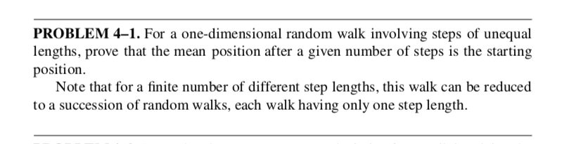

prove that the mean position after a given number of steps is the starting position

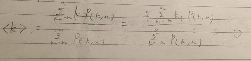

I think I can prove equal length version problem, But I am confusing in this case,,,
Please help me!
If you understand the case of 1 path length, consider the case of two allowed path lengths. If you can do that I believe the generalization will be evident.

You know the mean of equal-distance lengths is zero. Now take the hint given: you can make those equal-length steps as small as you like!
Thanks your reply.
If I make the length of one step 0, the mean of length is 0.
##k→0,<k>=0##
So,,,,,I don't know what does this mean :<

hutchphd said:
First things first. Make good on your "I think I can"...and show me

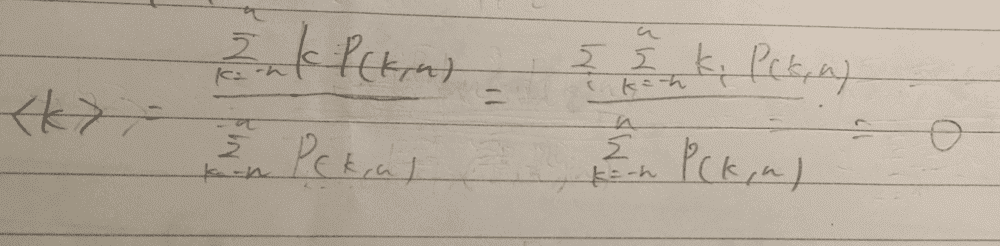

246458
Is it wrong this photo??I thought this can prove equal length version.
If this is wrong, I have to withdraw my statement. ;;
Your formula for <k> is correct but how do I know it sums to zero?
##P(n,k)=P(-n,k)##
So, the pair of numerator are canceled and the one having ##k=0## is uncancelled. this shows the sum is zero, right??
arcTomato said:
##P(n,k)=P(-n,k)##
Exactly. You would formally write that as
##ΣkP(n,k)=ΣkP(n,k)-ΣkP(-n,k)##
##=k Σ(P(n,k)-P(-n,k))=0 ##,, by symmetry
and you would explicitly delimit the sums (I'm too lazy )
I think you see that the multi-length sum can be manipulated simply to produce the same result
You don't need any fancy math.

I think I got it
How can I write the calculation process?
##<k>=<k_0+k_1+k_2,,,,>=<k_0>+<k_1>+<k_2>+,,,,,=0##
right??
arcTomato said:
I think I got it
right??
Absolutely.

I don't see how that results in a proof. What is the mapping between this and the original problem? E.g. how does a sequence of n steps translate, and where might you end up?
Secondly, it gets a little messy if the two lengths have an irrational ratio.
Thirdly, although I do not get the point of the hint, you seem to have misread it. It says, a succession of random walks, wherein each random walk has a single step length (implying that different walks in the sequence can have different step lengths).
