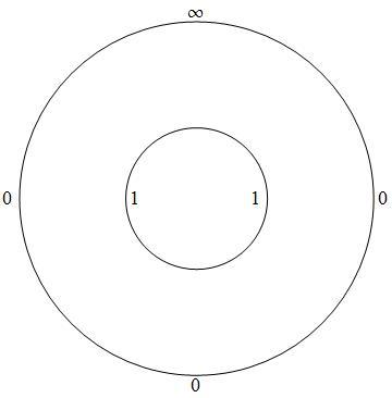

I was wondering if someone could confirm my suspicion about a particular property of Riemann surfaces of algebraic functions:
Are singular points on Riemann surfaces duplicated according to the number of branches about the point?
Take for example the function ##w=z^{1/3}(1-z)^{1/2}##. This function ramifies into three 2-cycle branches at the origin, two 3-cycle branches at one, and a fully-ramified branch at infinity. The Riemann surface is a torus and the function should map the torus to a six-sheeted covering of the complex plane. Does that mapping have three points labeled ##(0,0)##, two labeled ##(1,0)## and a single point ##\infty##? If true, then we should at least be able to construct such a mapping qualitatively according to the following diagram. An actual mapping may not of course have the singular points located where I've placed them.
Correct or no?
Ok thanks,
Jack
