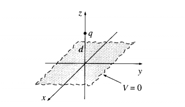

Say we have a point charge +q above an infinite plate. How can we show that the charge that accumulates on the upper surface of the plate is −q?
There are two ways I've usually seen this explained.
The first is with image charges...I accept that explanation. However, according to the books I've been learning E&M from, there's a different way...
The other argument I've heard is with a Gaussian cube whose bottom part goes through the plate and top and sides are infinitely far away...but, I don't understand this argument.
I understand that if we make a Gaussian surface that has the bottom inside the plate,then the flux through that bottom part must be zero.
However, I don't buy the argument that if we put the top and sides infinitely far, the flux through them would be zero.
After all, as we grow the Gaussian cube, the areas of the top and the sides would increase proportionally to r2r2, just as the strength of the electric field would decrease inversely proportionally to r2r2, where rr is the side-length of the cube.
Why is it that the flux through the sides and the top must be zero as well? I don't understand the infinity argument, because if we have an infinitely large sphere with a point charge inside, its not like we can say that the flux through the sphere is zero just because the sphere's walls are infinitely far away?
Thanks!

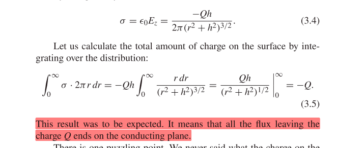

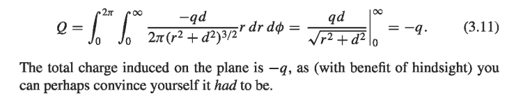

I know that we can show it with the method of images. However, both in Purcell and in Griffiths, the authors hint that the answer could've been arrived at some different way:
Griffiths:
Purcell:
What is this different way, and why does it work? Thank you!
