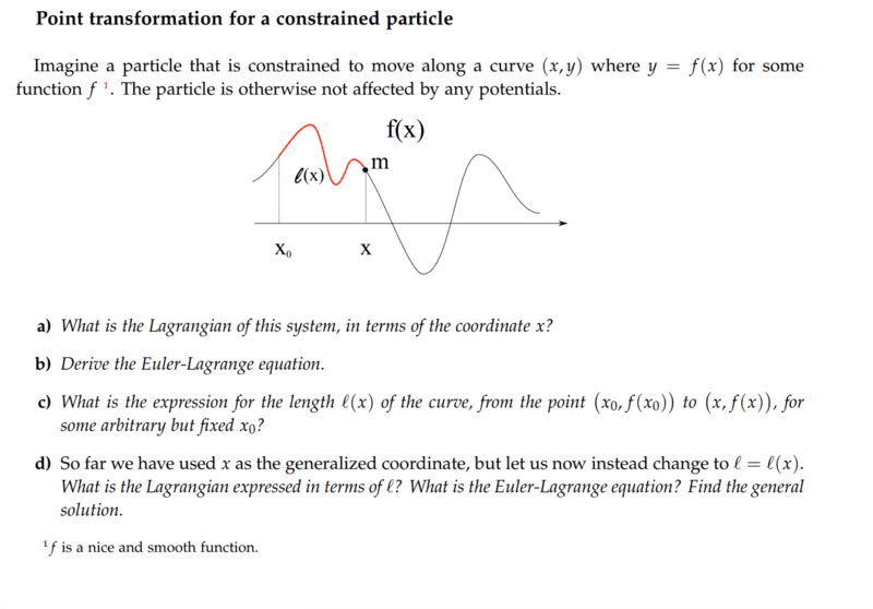

Hi,
unfortunately, I'm not that fit concerning the Lagrangian formalism, so I'm not sure if I solved the problem 1a correctly.
I have now proceeded as follows
the Lagrangian is
$$L=T-U$$
Since there are no constraining or other forces acting on the point mass, I assume that the potential energy is 0 and thus the system has only kinetic energy, i.e.
$$T=\frac{1}{2}m*(\dot{x}^2+\dot{y}^2)$$
I would now represent the entire equation in the x coordinate only, so.
$$x=x$$
$$y=f(x)$$
Insert into the Lagrangian $$T=\frac{1}{2}m*(\dot{x}^2+\dot{f}^2(x))$$
Thus, I would be done with task 1a, or did I do something wrong?
That is correct, except that if [itex]y = f(x)[/itex] then [itex]\dot y = f'(x)\dot x[/itex], so [tex] T = \frac12 m (1 + f'(x)^2)\dot x^2[/tex].
Thank you pasmith for your help 👍 , I had completely forgotten the chain rule.
Concerning task b, the Euler-Lagrange equation is as follows
$$\frac{\partial L}{\partial x}-\frac{d}{dt}\frac{\partial L}{\partial \dot{x}}=0$$
For $$\frac{\partial L}{\partial x}$$
I am not quite sure since f(x) depends on x, would the following then apply
$$\frac{\partial L}{\partial x}=m f''(x)$$
and
$$\frac{\partial L}{\partial \dot{x}}=m\dot{x}+m f'(x)^2\dot{x}$$
$$\frac{d}{dt}m\dot{x}+m f'(x)^2\dot{x}=m\ddot{x}+m f''(x)^2\ddot{x}\dot{x}$$
Then the Euler-Lagrange equation is
$$m f''(x)-m\ddot{x}-m f''(x)^2\ddot{x}\dot{x}=0$$
Your lagrangian is [itex]L = \frac12 m g(x)\dot x^2[/itex] where [itex]g(x) = 1 + f'(x)^2[/itex]. Hence [tex] \begin{split}<br /> \frac{d}{dt}\left( \frac{\partial L}{\partial \dot x}\right) - \frac{\partial L}{\partial x} &= \frac{d}{dt}(mg(x)\dot x)<br /> - \tfrac12 m g'(x) \dot x^2 \\<br /> &= mg(x) \ddot x + mg'(x) \dot x^2 - \tfrac12 m g'(x) \dot x^2 \\<br /> &= mg(x) \ddot x + \tfrac12 m g'(x) \dot x^2. \end{split}[/tex] So what is [itex]g'(x)[/itex] using the chain rule?

I have now formed the derivative of ##g(x)=1+f'(x)^2## as follows.
The outer derivative is ##2f'(x)##and the inner derivative would be ##f''(x)##
Thus, the derivative of ##g'(x)## would be ##g'(x)=2f'(x)f''(x)##
The Euler-Lagrange equation is ##m\ddot{x}+mf'(x)^2\ddot{x}+mf'(x)f''(x)\dot{x}^2##Concerning task part c and d
##\textbf{task c}##
##|l(x)|=\int_{x_0}^{x} \sqrt{1+f'(x)^2}dx##
##\textbf{task d}##
I would now simply parameterize the curve ##l(x)=\left(\begin{array}{c} x \\ f(x) \end{array}\right)## of ##[x_0,x]## with ##l_1=x## and ##l_2=f(x)##
Then the Lagrange function would look like ##L=\frac{1}{2}m(\dot{l_1}^2+\dot{l_2}^2)##
