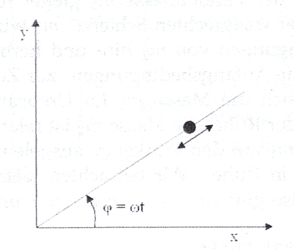

The bead can glide freely along the rod rotating with constant angular velocity on the xy-plane. What is the constraint force exerted by the rod?
##\dot\varphi=\omega##
Consider the following setup
Diagram of a rotating rod in the x-y plane: a straight rod from the origin at angle phi = omega t from the x-axis, with a bead on it marked by a dot and a double-headed arrow along the rod.
where the bead can glide along the rod without friction, and the rod rotates with a constant angular velocity ##\omega##, and we want to find the constraint force using Lagrange multipliers.
I chose the generalized coordinates ##q=\{r,\varphi\}## and the constraint equation ##f## to be ##\varphi=\omega t##

However, this is not true and the force is supposed to be ##C= 2m\omega^2 s_0 \sinh(\omega t)##, what am I doing wrong?

I think you should include the constraint explicitly in the Lagrangian: [tex] \mathcal{L} = \tfrac12m(\dot s^2 + s^2 \dot \varphi^2) - mgs\sin \varphi + m\lambda(\varphi - \omega t).[/tex]

How do you justify the last line? You correctly found the derivatives of the Lagrangian, but you didn't put them together to form the EOM correctly. I get [tex]\begin{split}<br /> \ddot s - s \dot\varphi^2 &= -g\sin\varphi \\<br /> \frac{d}{dt}(s^2\dot\varphi) &= -gs\cos \varphi + \lambda \\<br /> \varphi &= \omega t \end{split}[/tex] After setting [itex]\varphi = \omega t[/itex] the equation for [itex]s[/itex] is [tex] \ddot s - \omega^2 s = -g\sin(\omega t).[/tex]

I don't think you are supposed to include the force of gravity in this problem. So, you can set g = 0 in your equations. Thus, equation (4) becomes $$ 2ms\dot s \omega =\lambda\frac {\partial f}{\partial\varphi} = \lambda \,\,\,\,\,\,\,\,\,(4)$$
For the differential equation for ##s##, you wrote $$
m\ddot s = ms\dot \varphi^2 =ms\dot\omega^2\ \Rightarrow\ s(t)=s_0 \cos(\omega t) \,\,\,\,\,\,\,\,\,\,\, (7)$$ The differential equation is correct, except ##\dot \varphi## equals ##\omega## instead of ##\dot \omega##. But the solution ##s(t)=s_0 \cos(\omega t)## is not correct. ##\cos(\omega t)## would be a solution to the equation ##\ddot s = - \omega^2 s## (note the negative sign).
Your approach to finding ##\lambda## is correct, but of course you'll need the correct solution for ##s(t)##.
However, ##\lambda## is the ##\varphi## component of the "generalized" constraint force ##Q_{\varphi}##, not the ##\varphi## component of the actual, physical constraint force ##F_{\varphi}## that you are asked to find. ##Q_{\varphi}## does not have the correct dimensions of an actual force.
##Q_{\varphi}## is defined such that the work done by the constraint force when ##\varphi## changes by ##d\varphi## is $$dW = Q_{\varphi} d\varphi.$$ In terms of the actual force ##F_{\varphi}##, this work would be $$dW = F_{\varphi} {r d\varphi}.$$ Note that ##r d\varphi## is the actual physical distance associated with the movement of a point of the rod located at radial distance ##r## when ##\varphi## changes by ##d \varphi##. Comparing the two expressions for ##dW##, you can see the relation between ##Q_{\varphi}## and ##F_{\varphi}##.

In this problem, the only force acting on the bead is the time-dependent normal force from the rod. This force acts perpendicularly to the rod. The bead slides freely on the rod, so there is no constraint force acting parallel to the rod. The normal force is the only constraint force.
It is easy to find the normal force without using Lagrangian mechanics. In polar coordinates##(r, \varphi)##, the acceleration components are well-known to be
##a_r = \ddot r - r^2 \dot \varphi^2##
and
##a_{\varphi} = r \ddot \varphi + 2 \dot r \dot \varphi##.
Since there is no force in the ##r## direction, ##a_r = 0##. Thus, ##\ddot r - r^2 \dot \varphi^2= 0##.
From the constraint ##\varphi = \omega t##, we get the differential equation for ##r##: ##\,\,\,\, \ddot r - \omega^2r = 0##
With initial conditions ##r(0) = r_0## and ##\dot r(0) = 0##, the solution for ##r(t)## is ##r(t) = r_0\cosh(\omega t)##
The normal force (constraint force) is obtained from ##\sum F_{\varphi} = m a_{\varphi} \,## :
##N = m(r \ddot \varphi + 2 \dot r \dot \varphi)= m(0 + 2 \dot r \omega) = 2m\omega^2 r_0 \sinh(\omega t)##
