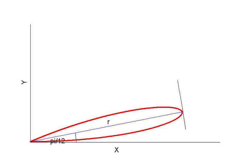

I don't know how to make theta so
∅ = theta.
find the slope of the tangent line at
r = sin(6∅) when ∅ = pi/12
y=rsin(6∅)
x=rcos(6∅)
r=sin(6∅)
tangent line equation
y-y' = m(x-x')
m = dy/dx
when ∅ = pi/12 then sin(6∅) = 1
so
r=1
x=rcos(6∅) = 0
y = rsin(6∅) = 1
so If I did the previous parts correctly, then I'm now attempting to find the slope (m).
I do not know how to find it.
m = dy/dx =EITHER= (dy/dr) / (dx/dr) or (dy/d∅) / (dx/d∅). Either way I wouldn't know how to take the derivatives if I did know which one to choose.
Am I doing this correctly? Am I on the right track? Thanks :)

so when r=sin6θ=1 that is when the sin function is at a max. therefore the slope is zero?
Precisely.
r is maximum as function of theta, which does not mean that the slope of the curve is zero. See picture.
The equation of the curve in polar coordinates is r=sin(6θ). How would you write the Cartesian coordinates x,y as functions of θ?

Wow, somehow I completely ignored that ∅ was the polar angle.
What I suggested in my opening post is wrong because you are not plotting r versus ∅. r and ∅ are polar representation.
Likewise, evaluating r'(∅=pi/15) here is incorrect because we are not plotting r versus theta.
Do as I said in my last post and parametrise the curve to get eqns for x and y. The find dy/dx.
(Thanks ehild for letting me know of my mistakes)

slope = dy/dx = (dy/dθ) / (dx/dθ)
I went in and saw my teacher at this part but I lost the sheet she wrote on because I'm a noob ;-(. But it went something like dy/dr(some sin's and cosines) / dx/dr(some sin's and cosines)
but I have no idea what she did now or how she did it or why it made sense at all. Any help appreciated.

It is given that r=sin(6θ). So the Cartesian coordinates are x=sin(6θ)cos(θ) and y=sin(6θ)sin(θ).
Derive both of them with respect to θ. The slope is dy/dx=(dy/dθ)/(dx/dθ).

dy/dθ = 6sinθcos(6θ) + sin(6θ)cos(θ)
dx/dθ = 1/2(5cos(5θ) + 7cos(7θ)
(dy/dθ)/(dx/dθ) = (6sinθcos(6θ) + sin(6θ)cos(θ)) / (1/2(5cos(5θ) + 7cos(7θ))
when θ = ∏/12...
(6sin(∏/12)cos(6∏/12) + sin(6∏/12)cos(∏/12)) / (1/2(5cos(5∏/12) + 7cos(7∏/12))
(0 + .9659258) / (.6470476128 + -1.8117333)
= -.8293446126
Which my online thing says is wrong ;-(
Are you sure you did it correctly? Try again. Leave it in terms in of 6θ and θ. As 6θ=pi/2, both derivatives become very simple at θ=pi/12.
