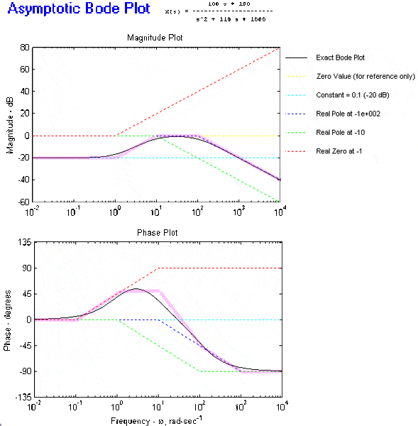

Hello all. I have two questions.
1] How do poles and zeros relate to bode plots? What happens at a pole or zero?
2] Can you come up with a rough sketch of a bode plot if you know the following (without having to use the transfer function)?:
- Zeros
- Poles
- H(s -> 0) Low frequency gain
- H(s -> infinity) High frequency gain
Thank you.

EDIT: Just read almost all of that wikipedia article you referred me to, It has a good explanation on how to do bode plots the standard way (using the 20log rule and so on) but I was wondering if there is anyway we can bypass all that work assuming we have the variables shown in my original post. The reason I ask this is because I currently have a somewhat complicated transfer function. Also, the article did have a part about poles and zeros but I still don't understand what they mean on the bode plot. I guess I need to do way more reading.

You could just have a computer evaluate the magnitude and phase of your transfer function for s = jω, 0 ≤ ω < ∞. MATLAB is a good tool for this.
Being able to draw a Bode plot using the asymptotic approximations is a good way to learn how to use them for control design, same with root locus analysis, but for the most part, I don't do it by hand any more.
I think their effect will become clear to you with some practice. You could try drawing Bode plots for some simple transfer functions.

Zeros, poles and DC gain uniquely determines your transfer function.

the gain at DC might be zero (like for a high-pass filter or even a band-pass filter). you might say that the loci of the zeros and the poles and the constant gain factor is what fully determines the transfer function and that fully determines the frequency response.

Sorry I should have mentioned that it won't hold for a system with a zero or pole at the origin.
I think Jim Hardy's response was incorrect. Every pole increases the slope -20db/decade (downward). Every zero increases the slope +20dB/decade (upward).

Here's a little tutorial with examples
http://lpsa.swarthmore.edu/Bode/BodeExamples.html

hey. Sorry for the late reply. Just want to say that your feedback has helped me so much. Poles dec. the slope by 20db/dec and zeros inc. slope by 20db/dec. That makes so much sense. Thank you everyone for your precious help, and a special thanks to Jim Hardy for the very useful information.
