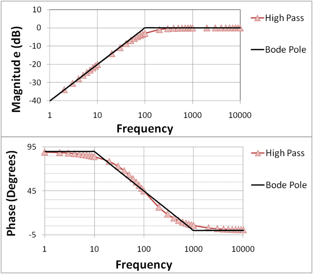

Hello,
After long time i am able to find Laplace transform function but can't understand the bode plot which give information of frequency response and magnitude i think
plaese anyway here how can push my thinking ahead in it?

Should both diagrams be correlated?

Sorry - but this is not an answer to my question (I did not ask if both are "equal").
The complete BODE diagram for each frequency dependent network consists of TWO drawings: (a) Magnitude vs. frequency and (b) phase vs. frequency.
You have shown two such diagrams - however, it seems that they are not for the same circuit (because the must be correlated!).
i have no idea get it from wiki.
any way how they should be correlated..
As I wrote already: Each frequency-dependent circuit (most simple example: RC lowpass) can be split into a magnitude and a phase function.
That is pure mathematics: H(jω)=|H(ω)|*exp(φ(ω)).
So you have two functions which are, of course, correlated because they come from the same circuit.
