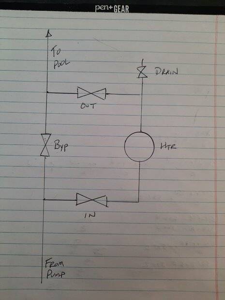

@Dullard beat me to it. If the heater isn't plumbed in yet, can you do it like this? Then Close valve "out" and open "drain," then throttle "byp" until it takes 38 seconds to fill the 5 gallon bucket (catching the flow out of "drain."

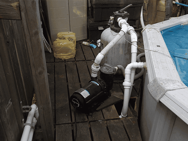

It is but that won't give my any numbers. I can tell you the size of the pump, but that'll tell you nothing about the effect of filter and plumbing on flow rate.

Did you see the diagram in my previous post? It is not perfect but it is surely close enough. Plus you want to plumb the heater in with valves so you can take it out when it breaks down. So the only addition is the drain valve, also probably a good idea to have anyway.
I did. My system (sans heater) is already set up, so not a lot of leeway. The manual's diagram is pretty much the same as your diagram. Except drain is off filter.

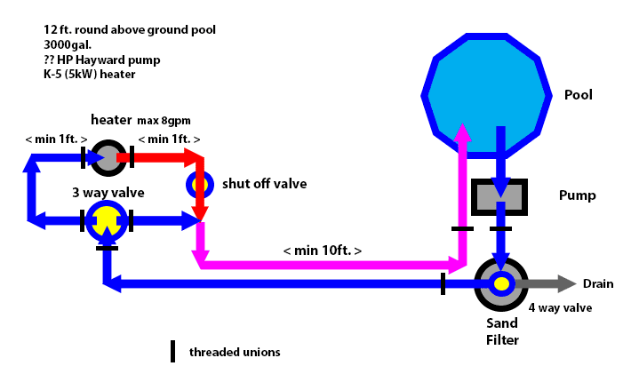

This is my setup:
The temperature issue only is a problem for too slow flow.
So does the pump run continuously? 8gal/min would be ~500gal/hr so it will cycle the pool in 6 hr. Surely it needn't be much bigger than that?
I have two comments on the plumbing:
1) A union downstream of the Shutoff Valve may be useful
2) If the Violet line, ('To Pool') enters below water level, a shutoff valve there would be useful (probably with unions)

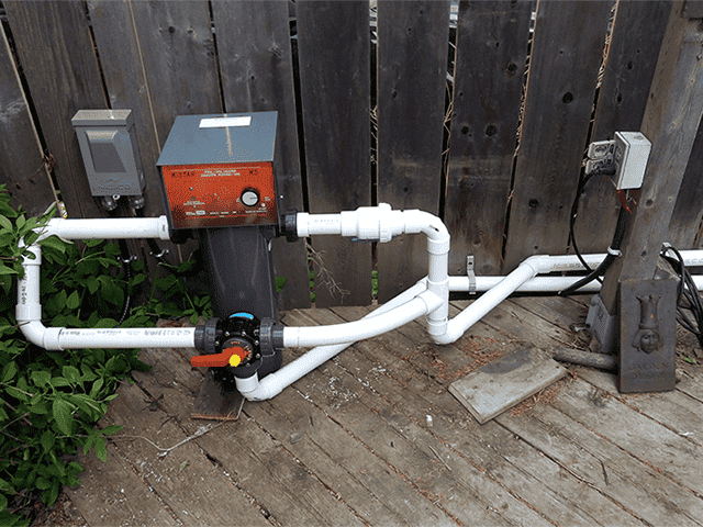

OK, now for the payoff:
patience ... patience ...
In that photo of the installed heater, There should be at least a drip shield (hood) over the power outlet.
There are also configurations available with a clear plastic front enclosure that is hinged at the top and the cord(s) exit at the bottom.
Both good to reduce corrosion, nuisance tripping of GFI, etc.
