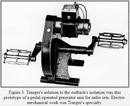

Here's another solution. Additional description is at http://www.antiqueradio.com/traeger_pedal_07-99.html.
Black-and-white photo of a pedal-operated generator unit with a large flywheel, a motor-like housing on top, and two pedals with straps on crank arms, mounted on a metal base.

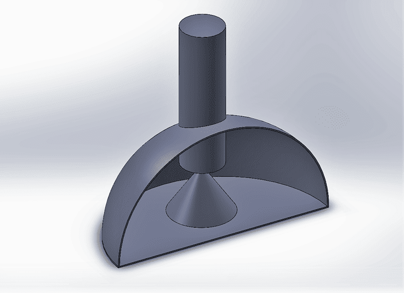

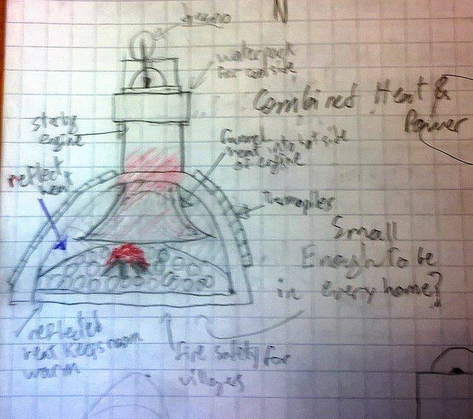

There are two "designs" (not full designs, more like ideas) that are competing right now:
The first model is where we use the fire that each villager makes (in each house) to generate and store a small amount of electricity. The device we imagined (picture drawing) is a quarter sphere "chimney-stove" made of copper or some other material with high thermal conductivity. The whole outside of the "chimney-stove" will be covered with thermoelectric generators (TEG modules) to capture the waste heat. The top of the "chimney-stove" which is the hottest part (because the fire will be touching this part) will have the hot side of a b-type sterling engine. The cool side of the engine will be outside at the top, and will be cooled with a water pack or heat sink, and by the air (15 degrees C). The sterling engine turns a disk which turns a motor (or some similar arrangement to run a motor). The motor and the TEG are connected to a regulator which is connected to a battery or an appliance (depending on output power). I am currently in the process of figuring out the potential power output of this design, and would appreciate any input on how to do this (I am trying to fin the Temperature at the hot side of the sterling engine and on the outside surface of the device given a 1000 degree C fire producing 10KW heat). Also attached is a picture of a rudimentary CAD drawing of the design (the cone is the fire and the cylinder is the sterling engine, the motor and thermoelectric generators are not shown)

Fireplace "Chimney-Stove" Design:
Disadvantages:
  • Immediate drawback is that each household has to have one of these, which may mean that this option will be more expensive.
  • 1 device only may not produce enough power to charge all the laptop and several of these devices charging several batteries will suffer from more inefficiency. However, the details of this remain unknown because I haven't yet calculated the potential power output possible. (would love some help with that)
  • May be very heavy depending on the size and the material.
  • The sterling engine may easily break down, and I was told that it is hard to re-calibrate such a device (never built one so I don't know, anyone have any experience with this?)
Advantages:
  • If the device produces enough power, each household will have autonomy, and won't need to draw power from a centralized generator that depends on the wind, meaning each house can even light a light bulb and not rely on fire light to study. (the wind turbine will most likely only be able to power the laptops and the phones, if we aim to keep the device small and portable <30kg)
  • This is a power generation, heating, cooking, and fireplace device. It improves protection and security from fire hazards by keeping the fire contained and not open, it helps direct the heat of the fire to one side of the room (like a fireplace or chimney), it can be used as an oven or wood stove, and it simultaneously generates power while in use. I would imagine the efficiency will be very high.
  • The device is minimally invasive in the sense that, villagers do not have to spend too much energy setting it up, and don't have to significantly change their lifestyles to run it. All the villagers have to do is to continue to make a fire and cook and heat with it.
  • This device has allot more market potential than a wind generator, especially for camping enthusiasts. (depending on how big and heavy it will be) This is because of it's many functions.

Edit: Also, some back of envelope calculations for the flue gas generation idea. You'll have a propeller in the flue to capture energy. The pressure drop across the prop times the mass flow rate is the simplest estimate of the energy available. What numbers do you have for the two,parameters?
