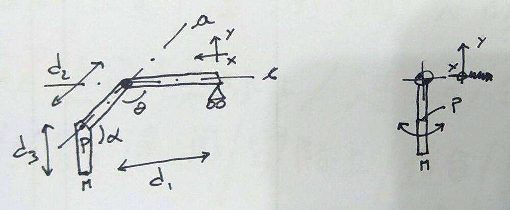

Hi,
I have this scheme, in which there are 3 segments:
- I is coaxial to c axis and free to rotate in the origin. Length d1
- II is coaxial with a axis and free to rotate around c axis. There a fixed angle θ between a and c axis. Length d2
- III is welded to II, it's the PM segment. α is fixed between a axis and segment III. Length d2
Both a and c axis are free rotate of about 10" per step, so they have not continuous movement. About 130.000 possible position for a 360 deg rotation.
I'd like to find a relation between position of point M in function of angles: so ##M(x,y,z)=f(\alpha, \gamma)## where ##\alpha = a_{axis}## angular position and ##\gamma = c_{axis}## angular position, ##0 \leq \gamma, \alpha \lt 360 ° ##
How could i proceed?
I can easily achieve the result fixing c axis and only rotating a axis, but i don't know how to combine them together.
For example, if a axis is fixed i will obtain ##x^2 + z^2 = (d_3+d_2 \cos\theta)^2##

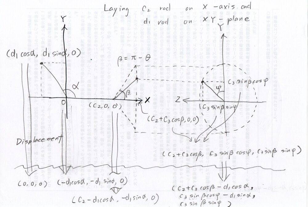

Hi. Laying intermediate ##C_2## rod on X axis and ##d_1## rod on XY plane would be helpful. See attached figure.
  • Handwritten sketch of rod positions in three views: a rod of length d1 at angle alpha in the XY plane with coordinates (d1 cos alpha, d1 sin alpha, 0), and a rod C2 on the X axis, plus a rod C3 at angle beta and phi with its endpoint coordinates (C2 + C3 cos beta - d1 cos alpha, C3 sin beta cos phi - d1 sin alpha, C3 sin beta sin phi).

I noticed I used ## \alpha## twice. It's the angle of rotation of d2 and d3 around a axis. It's not the angle between d2 and d3 (that's a constant angle). The 2 degree of freedom are the rotations around a and c axis.

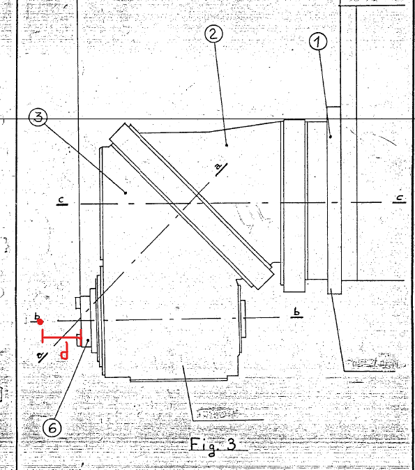

I've found a better image. How to outline the possible movements on an excel file?
Technical line drawing labeled Fig. 3 of a mechanical assembly with numbered parts 1, 2, 3 and 6, dashed axis lines marked b, c and a, and red dimension marks labeled d and b.

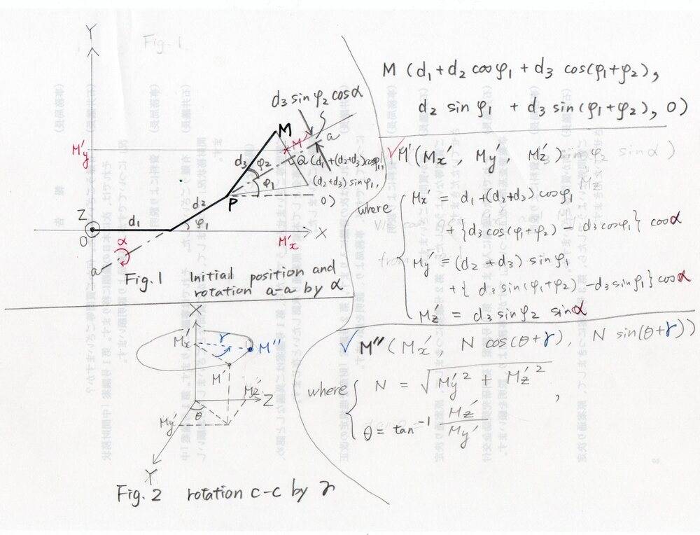

@Andrea Vironda Thanks for your sketch. Now I think I understand the problem. I consider the process of rotation a-a by ##\alpha## : M to M' then rotation c-c by ##\gamma## : M' to M" as attached.

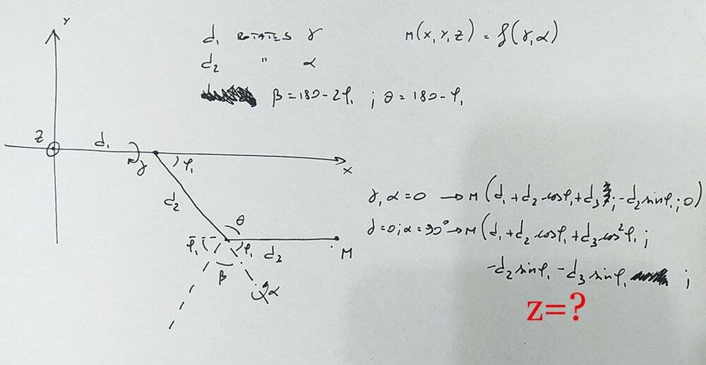

Consider that d1 and d3 are parallel at ##\alpha, \beta = 0##. In my attachment there's the correct position in M, but when i have ##\alpha = 90## I can't find the z position.
I can't imagine in my mind how much d3 is raised by ##\alpha## rotation

Hi. From your sketch attached, I see the problem says ##\phi_2=\phi_1=\phi## in my previous post.[tex]M[\alpha=0,\gamma=0]=(d_1+d_2 \cos\phi+d_3 cos 2\phi,\ d_2 sin\phi+d_3 sin 2\phi,\ 0)[/tex]
As an initial position I take upper-full bent position and you take downer-parallel position, but they show no difference in essence. I will follow your way so as you said
[tex]M[\alpha=0,\gamma=0]=(d_1+d_2 \cos\phi+d_3, \ -d_2 sin\phi,\ 0)[/tex]
Rotation with a-a axis by ##\alpha##. M flies up above XY plane and draw a circle of radius ##d_3 sin\phi##. P and the circle make a cone. Height of M (Z) is ##d_3 \ sin\phi \ \sin\alpha##. You should put plus minus signs in front depending on your definition of ##\alpha## turning direction.
You observe M draws a "standing" circle so X and Y coordinates also change with ##\alpha##. Careful consideration is needed as written in my sketch.
