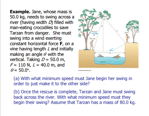

Everywhere I looked they solved this problem with energy conservation, but is it possible to solve it using centripetal acceleration?

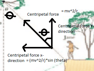

I tried putting (mv^2/r)*sin (theta) - F= ma which i solved for a. This gives me acceleration in x axis?
Then I used kinematic equation:
Did I think right, is it possible to use centripetal acceleration to solve this problem? Why? Why not? I got 8.6m/s as the initial speed I believe, the right answer is 6.15m/s

But could you please explain why I can't just decompose the radial acceleration in the x-axis. Is it because centripetal force is not a real force?

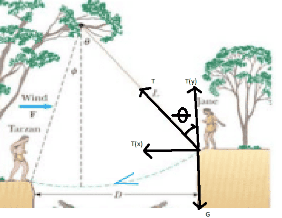

Partly. It's mainly because you did the force balance incorrectly. Let's see your free body diagram, and please call the tension that the vine exerts on the people T. Let x be the distance measured to the right from the point of attachment of the vine to the tree. Let y be the distance measured downward from the point of attachment of the vine to the tree. Let's see your force balance equations in the x and y directions.
Chet
Chet
ma(y)=T(y)-G
ma(x)=T(x)-F
T=√(T(y)^2+T(x)^2)
mv^2/r=√((T(y)-G)^2+(T(x)-F)^2)) - is this one right?
Warlic said:
View attachment 91963ma(y)=T(y)-G
ma(x)=T(x)-F
T=√(T(y)^2+T(x)^2)
Your original force balances are OK, but not this final equation. It should read:
$$m\frac{v^2}{r}=T-Fsinθ-Gcosθ$$
Thank you very much, could I just ask you one last question - how did you get that equation? It makes sense, when the vine is straight down its going to be T-F*0-G*1= T-G
and if the vine is totally horizontal its going to be T-F*1-G*0= T-F. But how did you see that it was going to be -F*sin(theta) and - G*cos(theta). I don't see the correlation between theta and the forces F and G.
Fsin(theta) is the component of F along the vine and G cos(theta) is the component of G along the vine.
The thing that was wrong with your equation in post #5 is that it assumes that the acceleration is totally centripetal, and it is not. There is a component of acceleration in the direction tangent to the arc. The tangential velocity is changing along the arc. The equation that I wrote gives the component of the force balance in the direction perpendicular to the arc (along the vine).
Centripetal force is real, in the sense that it is not a fictitious force, as centrifugal force is. But it is not an applied force. Rather, it is that component of the resultant of all the applied forces which accounts for the radial acceleration.
