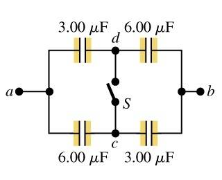

The capacitors in the Figure are initially uncharged and are connected, as in the diagram, with switch S open. The applied potential difference is V_ab = + 210V
What is the potential difference V_ad after switch S is closed?
Q=C_eq*V
V_ab=Q/C
I really have no idea how to get started doing this problem. The first part of the problem asked "What is the potential difference V_cd?" This I found easy but once you close the switch I'm not sure how to approach the problem. Specifically how do you go about combining the capacitors to get a C_eq. Thanks for any help.
  • Circuit diagram of four capacitors in a bridge arrangement between terminals a and b, with a switch S linking nodes d and c; capacitors labelled 3.00 μF (top left), 6.00 μF (top right), 6.00 μF (bottom left), 3.00 μF (bottom right).

Hi Black Armadillo! :smile:
Hint: the potential at c and d is the same, so draw the diagram again without the line cd, with the points c and d the same. :wink:
